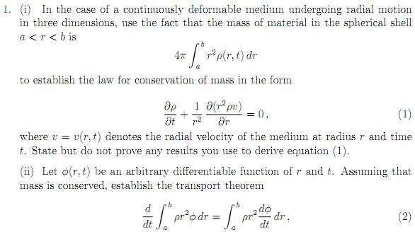

Show that
\frac{d}{dt}\int \rho r^{2}\phi dr = \int \rho r^{2}\frac{d\phi}{dr} dr
Fundamental theorem of calculus
So I follow the derivation from the textbook and I think I get the rather sneaky rearrangement of the derivatives, but I do not see how
\int \rho r^{2}\frac{d\phi}{dt} dr = \int \rho r^{2}\left(\frac{\partial \phi}{\partial t}+v\frac{\partial \phi}{\partial r}\right)dr
Note: Integrals are evaluated from a to b, and v(x,t) = dx/dt (e.g. da/dt = v(a,t))
What do the variables depend on? I don't see any problem with the line given a t and r dependence in phi. What subject is this in? Care to share some more problem details?
Sorry, I thought it was something standard. It is a mechanics course.
t-time, r - radius, \rho (r,t) is density, \phi (r,t) is an arbitrary differentiable function, a=a(t), b=b(t)
EDIT:
Nevermind, it is simply using the definition of the total derivative. That's all there is to it...
