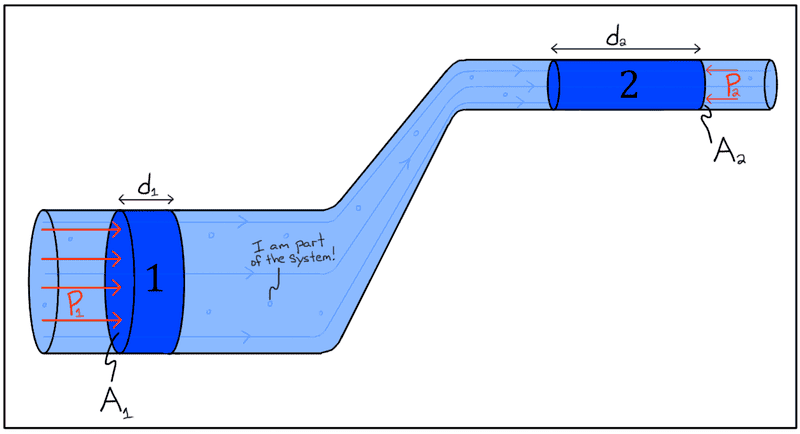

So the Bernoulli's EQ comes from conservation of energy. From the figure, I see that if Force 1 is greater than Force 2, the water will move to the right.
The distance Force 1 travels gives work of F1d1, and the distance Force 2 is pushed back gives work F2d2, and net work on the system is F1d1 - F2d2.
But then you have to equate the net work to the PE and KE change of the system, to get F1d1 - F2d2 = (0.5mv22 + mgh2) - (0.5mv12 + mgh1).
But that seems to imply the volume of water displaced at the left suddenly appears at the displaced water on the right.
I understand that both volumes of water are equal, but it seems as the though the water on the right side BEFORE it was pushed was already in the same pipe at the same height. So after pushing, the water at the right only changed horizontal position. Same for the left side, too. So shouldn't the differences in mgh be 0?

The two volumes of water are not different volumes of water being examined at the same time, they are the same volume of water examined at different times.
If you envision a piston pushing the fluid below to the right and another piston being pushed by the fluid above to the right, then, during a small time interval, the potential energy of the volume of fluid contained between the two pistons (a closed system) increases.

Can you explain why the KE in the flat sections doesn't change?
I agree, but when you push the water, the left side water goes from the left pipe and into the beginning of the sloped section and the same volume exits the sloped section from the top and into the right side pipe. How can we compare the energies of the sections of water when they came from different places? It is not as though the water from the left pipe teleported itself to the right side.
Shouldn't we be examining the KE and PE changes of just the water of one section? Like look at the KE and PE change of left side as it goes from the flat section to the entry of the sloped section?

You definitely need to include the KE and PE changes also. If you follow the approach I outlined in post #4, then you are dealing with a closed system that is experiencing a transient change, and work is being done on the fluid at both moving boundaries as well as the potential energy and kinetic energy of the fluid between the moving boundaries changing. The expanded version of the first law of thermodynamics captures all this if one neglects the change in internal energy (temperature of the fluid).
Your course is trying to get you to transition from the closed system version of the first law of thermodynamics to the open system (control volume) version, which involves an energy balance over a control volume, with fluid entering and leaving. In such a case, the development usually starts out considering steady state flow, where none of the parameters are changing with time at all fixed spatial location. In this framework, a parcel of fluid entering at the bottom is imagined to instantly exit at the top, because nothing is changing with time in-between.
The two developments I described are totally equivalent, and it is important to understand intuitively how the two are related. The Reynolds Transport theorem alluded to by @boneh3ad captures all this mathematically.

I guess I didn't explain very well.
The beauty of the Bernoulli equation (which is nothing more than a steady state version of the open system form of the first law of thermodynamics, involving a single entering- and exit stream, with no heat transfer or shaft work, for an inviscid fluid) is that it allows us to treat the control volume as a black box, and to focus exclusively on the conditions at the inlet and outlet cross sections only.
Anyway, no work is done in the tapered section because the walls are rigid. All the work is done at the inlet and outlet cross sections.
I also didn't do a very good job about explaining with regard to my "pistons" example. I was trying to offer a different perspective on all this by reverting to a closed system transient version of the first law of thermodynamics in which the fluid behind the large slug of fluid we are considering (i.e., between the inlet and outlet cross sections) is acting as a piston to do work on our slug at cross section A, and the fluid ahead of the large slug of fluid we are considering is acting like a piston to receive work from our slug at cross section B. So there is no dynamic change associated with these fictitious pistons and no waves involved. The closed system version of the first law I am alluding to here is the expanded version, which includes changes in kinetic energy and potential energy (when appropriate):
$$\frac{dU}{dt}+\frac{d(KE)}{dt}+\frac{d(PE)}{dt}=\dot{Q}-\dot{W}$$where, in this system,$$\frac{dU}{dt}=0$$$$\dot{Q}=0$$and the rate of doing work on the system is given by $$\dot{W}=\dot{m}(P_Bv_B-P_Av_A)$$with ##\dot{m}## representing the mass rate of flow, P representing pressure, and v representing specific volume.

There is nothing wrong with looking at smaller subsystems of a larger system. In that case, work is being done at the boundaries of the smaller subsystem, but, again, not within the subsystem.
Work being done on smaller subsystems that are part of a larger system cancel out with one another, except at the boundaries of the larger system. Whenever we do an energy balance on a deformable system, we only include the work done at the boundary. So, once you define what you are calling your system, only the work done at the boundary is relevant.
Likes sophiecentaur
Can you explain why we are allowed to imagine that fluid entering at the bottom immediately exits the top? It doesn't seem like that's what happens in real life, so how does such a model work?
In real life, the fluid that enters the pipe was just immediately left of the entrance, and the fluid leaving was just at the left of the exit. The two parcels of water aren't the same.
They are not the same. But, if the system is at steady state, with nothing changing inside the control volume, it just works out mathematically to be the same as if the same parcel that entered the bottom exited immediately at the top.
