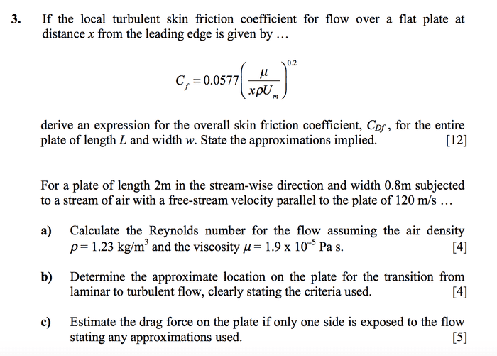

Turbulent friction coefficient over a plate
The discussion focuses on calculating the turbulent friction coefficient (Cf) over a plate using the equation Cf=0.0577(μ/xρUm)0.2. The user successfully completed parts a) and b) but is uncertain about their calculation for the first part, which yielded a CDf of 0.00421, differing from the expected value of 0.00263. They reference a document indicating that CD represents an integrated average of local Cf values over the surface area, suggesting further steps are needed after integration. The conversation highlights the importance of correctly applying the integration process to obtain accurate results. Understanding the relationship between local and average friction coefficients is crucial for solving the problem accurately.
pressurised
I've managed to do parts a) and b), however I don't believe my attempt at the first part is correct as I am using a different Cf than the value used in the mark scheme.
The expression I made for the first part is, 0.0577(μ/ρUm)0.2[x0.8], with limits L and 0.
This gave me a CDf of 0.00421, but it should be 0.00263:oldconfused:.
