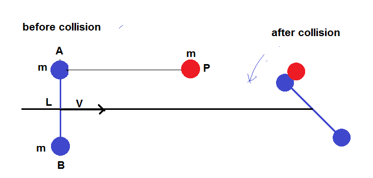

The length of the rod is along
y direction and (A+B+rod) is traveling along +x direction .
Since there is no external force along x direction momentum is conserved along x direction . If v' is velocity of CM of (A+B+P) then
2mv = 3mv' gives v' = 2v/3 .
Suppose O is a point on the table just below the new CM at the moment of collision . Now , I would like to conserve angular momentum about O .
My doubt is regarding the force exerted by the rod on the balls . If the force exerted by rod is along it's length then angular momentum can be conserved .
But is it correct to assume that the rod exerts a force only along its length ? Has it anything to do with the rod being light ?

You are right, the angular momentum of the system is conserved. From the text of the problem, the geometry should like as it shown in the picture.
A and P collide, and they exert force on each other during the collision. At this moment, the rod exerts force on the balls A and B in perpendicular directions, but you need not bother about it. Consider A, B, and the rod as a rigid body and find the angular momentum of the system before and after collision,

Beautiful picture !
