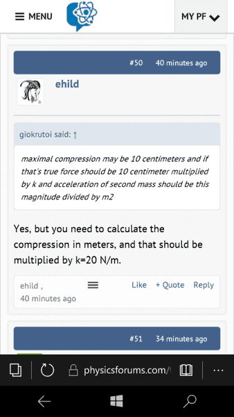

maximal compression may be 10 centimeters and if that's true force should be 10 centimeter multiplied by k and acceleration of second mass should be this magnitude divided by m2
and yes I mean right when I write write
Yes, but you need to calculate the compression in meters, and that should be multiplied by k=20 N/m.
