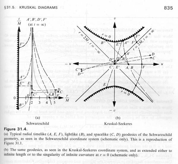

As I said in post 16, you can't treat dr/dt=0.5 as equivalent to "half the speed of light" in Schwarzschild coordinates, light itself doesn't move with dr/dt=1 in these coordinates.

Your post was too advanced for me but I see what you are saying. Not only is dr/dt = 1/2 impossible for r < 4M but in Schwarzschild coordinates dr/dt is not in units of the speed of light.
So a dr/dt value of 1/2 does not mean 1/2 the speed of light.
I guess if one just realizes that if dr/dt were 1/2 when r = 4M then
d[tex]\tau[/tex]
would equal zero which is impossible.
