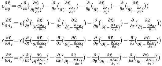

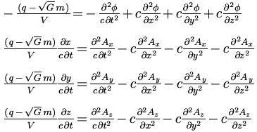

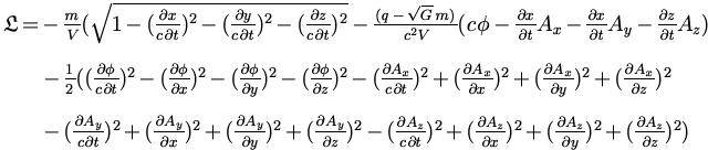

In this post I will start from the GEM unified field equation, and see what needs to be done to get to a quantum simple harmonic oscillator. This will establish a link between the GEM field equations and quantum mechanics.
A 4D homogeneous wave equation is the GEM vacuum equation:
(\frac{1}{c} \frac{\partial^2 phi}{\partial t^2} - c \nabla^2 \phi, \frac{1}{c} \frac{\partial^2 phi}{\partial t^2} - c \nabla^2 A) = 0
The 4D inhomogeneous equation is the source GEM equation:
(\frac{1}{c} \frac{\partial^2 phi}{\partial t^2} - c \nabla^2 \phi, \frac{1}{c} \frac{\partial^2 phi}{\partial t^2} - c \nabla^2 A) = (\rho_q - \rho_m, J_q - J_m)
We can see that the scalar part of this equation can deal with Gauss' law of EM and Newton's law of gravity in a way consistent with special relativity since this equation in manifestly covariant under a Lorentz transformation (a fancy way of saying we know exactly how everything changes). The waves travel at the speed c. It is critical to note that this equation uses covariant derivatives, the sort with a connection that can work fine on a curved manifold. It is unfortunate that some skilled people see a d'Alemberian operator on a flat Minkowski background (it is there), but do not also see this expression can have a dynamic metric and work in a curved spacetime. I have shown earlier how the Rosen metric solves this 4D inhomogeneous equation for a static point charge.
The next step is to add in a term to convert the wave equation into a simple harmonic oscillator. One needs to subtract the norm of a factor that depends on R times the 4-potential. I'll write out the expression in its smallest parts, so you can notice the similarities:
(\frac{1}{c} \frac{\partial}{\partial t}, c \nabla)^*(\frac{\partial}{\partial t}, \nabla)(\phi, A) - (\epsilon, R)^*(\epsilon, R)(\phi, A)= (\rho_q - \rho_m, J_q - J_m)
Multiply things out.
(\frac{1}{c} \frac{\partial^2 \phi}{\partial t^2} + c \nabla^2 \phi - (\epsilon^2 + R^2) \phi, \frac{1}{c} \frac{\partial^2 A}{\partial t^2} + c \nabla^2 A - (\epsilon^2 + R^2) A) = (\rho_q - \rho_m, J_q - J_m)
To make this simpler, imagine that the potential in no way depends on time. A few terms drop:
(c \nabla^2 \phi - (\epsilon^2 + R^2) \phi, c \nabla^2 A - (\epsilon^2 + R^2) A) = (\rho_q - \rho_m, J_q - J_m)
What we now have looks almost like a quantum simple harmonic oscillator, as written here: quantum SHO. The one difference is that the \epsilon is positive in that expression, and it is a squared negative here. Since that term contains energy, it may end up depending how positive and negative energy are defined.
The quantum simple harmonic oscillator is a particular class of the time-independent Schrödinger equation. I'll put up a quaternion derivation of the Schrödinger equation soon.
doug

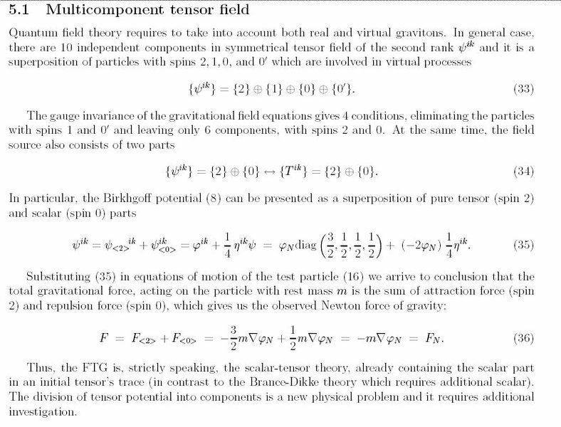

I gave a talk this morning at an APS meeting titled "Seeing Spin 2 Symmetry in GEM, a Unified Field Theory", and already it is up on YouTube :smile:
There were seven people in the room, and due to the nature of the meeting, they were all folks who work with atoms, molecules, and lasers, not gravity. I am using Keynote '08 for my presentations these days, and they have made it simpler to record and upload to YouTube. I did that at 11am on Friday night, and now three people have viewed the 15 minute talk, one of them giving it 5 stars. I like the global reach of YouTube! The number of folks that flock to a Saturday 8am meeting in Connecticut was limited exclusively to the other people giving talks and the moderator.
The video contains another presentation of the content in posts #319 and #320, but I got some new insights in preparing for the talk. Let me explain again what the problem is. There is a current coupling term in my vector unified field theory, J^{\mu}A_{\mu}. In Feynman's lecture book on gravity, chapter 3, he shows why a vector coupling term like J^{\mu}A_{\mu} has spin 1 symmetry, a great thing for EM because spin 1 particles dictate that like charges repel. That creates a HUGE problem for a unified field theory because for gravity, like charges attract. I think this is the key calculation why bright folks don't play with something like GEM.
The calculation that shows the current coupling term has spin 1 symmetry is correct as far as its assumptions go. The hidden assumption has to do with the orientation of the current and the 4-potential. You are free to work with a 4-potential pointing in any darn direction you want relative to the current J. The freedom to choose a different directions for the orientation of the potential means there might be different symmetries to the current coupling term. Look at it this way: J^{\mu}A_{\mu} evaluates to a scalar, and we cannot detect A_{\mu} directly (only how it changes), so we must consider different possible angles between the currents. In short, Feynman shows that J^* J&#039; has spin 1 symmetry, and I show that (i J i)^* J&#039; has both spin 1 and spin 2 symmetry. It is a great little calculation, and helps me understand why folks as bright as Feynman never stopped to take a serious look at a rank 1 field theory for gravity. The particle physics is wrong, until you recognized the freedom to orient the coupled currents differently to each other.
doug

You bring up a most excellent point, one I have been thinking about. EM is a gauge invariant theory, GEM is not. With EM, you can do a transformation like so:
A \rightarrow A&#039; = A - \nabla \phi
This new A' points in a different direction. That is a "legal move" in EM, not GEM, an allowable gauge transformation. I am making this a bit more specific, by looking at a rotation of A:
A \rightarrow A&#039; = A - \nabla \phi = (i A i)^*
The exercise is to compare the symmetry of the phase of A (spin 1) to A' (spin 1 and spin 2).
For GEM, I am not free to rotate A. Instead, I am free write A like so:
A = 1/2(A + (i A i)^*) + 1/2(A - (i A i)^*)
The 1/2(A + (i A i)*) has spin 1 symmetry, while 1/2(A - (i A i)*) has spin 2 symmetry in the phase. I have the freedom to represent the 4-potential in this way.
doug

Getting the Field Equations, the Standard Way
Hello Lut:
The field equations were the first things I derived when I wrote the GEM Lagrangian. They were the test that I had the right Lagrangian. What I did was write the Lagrangian in terms of the components:
I used this definition of the field equations:
which if you write out all the components looks like so:
Although there are lots of terms, it is kind of simple, since everything ends up being positive. The field equations are generated by taking the derivative of the Lagrangian with respect to the sixteen possible combinations of taking the 4-derivative of the 4-potential. The result is this:
This looks like
\Box^2A^{\mu} = J^{\mu}
Notice that I am using the complete asymmetric tensor, not the symmetric term in isolation. I'll have to look at what the scalar is from the contraction of the symmetric tensor. That should be a fun calculation! In other words, I have not calculated the field equations just for gravity.
doug

The G field equations
Hello Lut:
Great question about the G field equations. The Lagrangian needed for this looks like so:
\mathcal{L}_G = \frac{1}{c} J^{\mu} (A_{\mu} - I_{||} A_{\mu} I_{||})<br /> -\frac{1}{4c^{2}}(\nabla_{\mu}A_{\nu}+\nabla_{\nu}A_{\mu})(\nabla^{\mu}A^{\nu}+\nabla^{\nu}A^{\mu})<br />
Make sure you write out the coupling term in a way that splits out the transverse from the parallel parts. The parallel part is mediated by a spin 2 field where like charges attract.
Write this out in its component parts:
\mathcal{L}_G = -\frac{1}{c} \rho A_0 + \frac{1}{c}J_{||} A_{||}
+ \frac{1}{2c^2}( -(\frac{\partial \theta}{\partial t})^2 + (\frac{\partial A_x}{\partial x})^2 + (\frac{\partial A_y}{\partial y})^2 + (\frac{\partial A_z}{\partial z})^2
- (\frac{\partial A_x}{\partial t})^2 + 2 \frac{\partial A_x}{\partial t} \frac{\partial \theta}{\partial x} - (\frac{\partial \theta}{\partial x})^2
- (\frac{\partial A_y}{\partial t})^2 + 2 \frac{\partial A_y}{\partial t} \frac{\partial \theta}{\partial y} - (\frac{\partial \theta}{\partial y})^2
- (\frac{\partial A_z}{\partial t})^2 + 2 \frac{\partial A_z}{\partial t} \frac{\partial \theta}{\partial z} + (\frac{\partial \theta}{\partial z})^2
+ (\frac{\partial A_y}{\partial x})^2 + 2 \frac{\partial A_x}{\partial y} \frac{\partial A_y}{\partial x} + (\frac{\partial A_y}{\partial x})^2
+ (\frac{\partial A_z}{\partial x})^2 + 2 \frac{\partial A_x}{\partial z} \frac{\partial A_z}{\partial x} + (\frac{\partial A_x}{\partial z})^2
+ (\frac{\partial A_y}{\partial z})^2 + 2 \frac{\partial A_y}{\partial z} \frac{\partial A_z}{\partial y} + (\frac{\partial A_y}{\partial z})^2)
Wow, that's a lot of partial derivatives! Notice the simple pattern: either a term is squared with a 1/2 in front of it, or the term is mix, and has a coefficient of 1. When we start taking the derivatives of these things, the derivative of d \frac{1}{2}x^2/dx = x and d (x y)/dx = y. Now it is time to apply the Euler-Lagrange equation. First do the current, which is the derivative of the Lagrangian with respect to the potential:
\frac{\mathcal{L}_G}{\partial A^{\mu}} = -\frac{1}{c} \rho + \frac{1}{c}J_{||}}
The tougher part is taking the derivative with respect to all the fields. This part takes some practice, but it is cool if you can get it to all work out. Do this one guy at a time:
\frac{\partial}{\partial x^{\mu}}\frac{\mathcal{L}_G}{\partial \frac{\theta}{x^{\mu}}} = -\frac{\partial^2 \theta}{\partial t^2} + \frac{\partial^2 A}{\partial t \partial x} - \frac{\partial^2 \theta}{\partial x^2} + \frac{\partial^2 A}{\partial t \partial y} - \frac{\partial^2 \theta}{\partial y^2} + \frac{\partial^2 A}{\partial t \partial z} - \frac{\partial^2 \theta}{\partial z^2}
There are a few things to notice from this, the first of four field equations. The current density rho has the same negative sign as the second derivative terms of theta. That is good, because it is consistent with like charges attracting each other. We can rewrite pairs of terms in this kind of way:
+ \frac{\partial^2 A}{\partial t \partial x} - \frac{\partial^2 \theta}{\partial x^2} = + \frac{\partial}{\partial x}(\frac{\partial A}{\partial t} - \frac{\partial \theta}{\partial x})
Notice the difference in the sign between these two terms. For the E field, they are both minus signs. For gravity, they have different signs. Time to get the next field equation:
\frac{\partial}{\partial x^{\mu}}\frac{\mathcal{L}_G}{\partial \frac{A_x}{x^{\mu}}} = -\frac{\partial^2 A_x}{\partial t^2} + \frac{\partial^2 \theta}{\partial t \partial x} + \frac{\partial^2 A_x}{\partial x^2} - \frac{\partial^2 A_x}{\partial y^2} - \frac{\partial^2 A_y}{\partial x \partial y} - \frac{\partial^2 A_x}{\partial z^2} - \frac{\partial^2 A_z}{\partial x \partial z}
Here again we can rewrite a pair of these terms like so:
- \frac{\partial^2 A_x}{\partial y^2} - \frac{\partial^2 A_y}{\partial x \partial y} = - \frac{\partial}{\partial y}(\frac{\partial A_x}{\partial y} + \frac{\partial A_y}{\partial x})
This is "curl-like" in the way the different derivatives swap places, but it certainly is not the curl since both have the same sign. There is also the term + \frac{\partial^2 A_x}{\partial x^2} which is probably the "Lorentz gauge canceling" term.
I did this all first with pencil and eraser. It might be a good exercise in 19th century math to see if you can spot mistakes (it is hard to proof in LaTeX format). Kind of amazing to work with this many partial differential equations, and have it make sense. It does look consistent with Lut's statements based on tensor analysis.
doug
