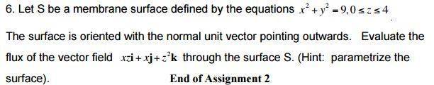

I thought of using the divergence theorem where
I find that ∇.F = 3z
thus integral is
∫ ∫ ∫ 3z r dz dr dθ where r dz dr dθ is the cylindrical coordinates
with limits
0<=z<=4
0<=r<=3
0<=θ<=2π
and solving gives me 216π
Can I use this method for this question? I'm skeptical about my method because the question talks about normal unit vector and paramatizing a surface
Well, this is a nice opportunity to verify the divergence theorem !
In principle you're free to ignore the hint, but I'm afraid some bad-tempered graders might think otherwise.
If you want to explore the path hinted at: what would you write for ##dS## at ##(x,y,z) = (r \cos \phi, r\sin \phi, z)##
(sorry for my genetically fixed notation for azimuthal angles :wink:)
Likes uzman1243

By the divergence theorem:
$$\iint_S \vec F \cdot d \vec S = \iiint_V \text{div}(\vec F) \space dV = \iiint_V 3z \space dV$$
The solid volume ##V## is the cylinder that sweeps the angle ##0 \leq \theta \leq 2 \pi##, has radius 3, and height 4. So yes the answer would be ##216 \pi##.
The question wants you to do this problem a little bit differently though. You need to parametrize the cylinder like so:
$$\vec r(\theta, z) = 3\text{cos}(\theta) \hat i + 3\text{sin}(\theta) \hat j + z \hat k$$
Then using this theorem:
$$\iint_S \vec F \cdot d \vec S = \iint_D \vec F(\vec r(\theta, z)) \cdot (\vec r_{\theta} \times \vec r_z) \space dA$$
The integral can be evaluated to obtain the same result by using polar co-ordinates.
Likes uzman1243
Technically the divergence theorem is not available here, since the surface S is not a closed surface.
Likes uzman1243 and BvU

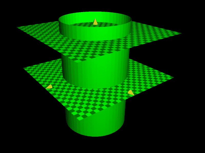

Also, I believe the surface is closed because it is the boundary of a solid region. Here is the surface:
The flux out of the top and bottom surfaces will cancel due to the orientations.
I don't think so. The vector field is different on the top surface than the bottom surface, particularly the z component, which is what is dotted with the normal.
If I were doing this problem, I would use the divergence theorem to allow me to integrate over the entire volume, and then I would subtract the net flux through the top and bottom surfaces. The latter would come out to 144π (basically out the top surface, since the flux out the bottom surface is zero).
Chet
Likes uzman1243

using divergence theorem I get 216pi. Using the surface integrals I get 72pi. The answer to solving using surface integrals should give me the same answer as using divergence theorem (provided it's a close surface).
Using the divergence theorem you get 216##\;\pi##. The top and bottom surface give 144##\;\pi##. The exercise wants only the side surface (although it doesn't state that all too explicitly, I must admit).
Reading this problem statement once again, I realize that interpretation is forced upon me by my own context: cylindrical membranes where you pump something in and something goes out through the membrane; the rest goes out at the other end. A cell biologist would have a totally different picture, I imagine. So the mathematician has to make sure the problem statement is unambiguous.
Likes uzman1243
so the answer is just 72 pi?
What I'm trying to say is: I don't know. The most literal mathematical interpretation of the exercise text would favor the 216.
But then I don't really understand the hint in the problem statement, because in that case the divergence route you took is more economical.
Likes uzman1243
No i think the exercise text means only the side surface cause it says ##x^2+y^2=9##.(notice the equality, its not <=) The points with (x,y) such that satisfy that equation lie all in the side surface, otherwise it would have state something like to include the bottom and up surfaces with ##x^2+y^2\leq 9,z=0,z=4##.
So the answer should be just 72pi.
If possible, can you please explain what you mean from the graph that was plotted in post #7?
I mean that the surface has only the points for which (x,y,z) are such that ## x^2+y^2=9## and ##0\leq z\leq 4##. (it is important that it is ##=9## and not ##\leq 9##) So that is not the whole closed surface as shows the graph in post 7, but only the side surface of the graph (that is the cylindrical surface without the top and the bottom surfaces). So if you apply the divergence theorem, then you got to subtract the flux through the bottom and up surfaces , so you have 216-144=72pi.
Likes uzman1243
Thank you so much. Finally makes sense.

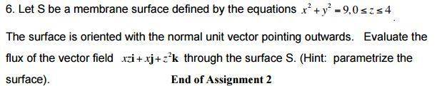

Just one more question, how do you know if a surface is closed? So that I could have used the divergence theorem here instead.
I believe pasmith is correct about the cylinder not being a closed surface actually, because a closed surface is compact and without boundary. The cylinder ##x^2 + y^2 = 9## has no top and no bottom, is hollow, and so is not a closed surface. Hence the divergence theorem does not apply.
I find this question weird because I have seen other examples with very similar givens that use the divergence theorem to calculate the net flux out of all surfaces:
I guess they have been doing it wrong the whole time.
As for this problem, you could either split up the three surfaces and calculate three surface integrals, or you could parametrize the surface as you have done already and find the answer to be ##72 \pi##.
Likes uzman1243
