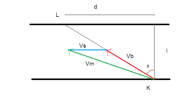

a student want to cross a river flowing east at a rate of 2.0km/hr in a boat on the south bank and arrive at point L on the north (north and west) side. Point L is 0.5km to the left or west from the starting point (point K - point K is on the south side). Point L is 0.5km (to the left) from a perpindicular line drawn from the starting point (K)
The student can row at 5.0km/hr.
How long will it take to paddle north-west up stream and arrive at point L?
the picture

The velocity with which the student can paddle is 5km/h. So having his velocity as 5km/h northwards AND 3 km/h westwards will obviously mean he is exceeding his capacity.
So instead, solve it this way. You know the student's final velocity has to lie on the line joining K and L. Call the velocity vector in this direction v. Now, the vector sum of the the velocity of stream and the boat's velocity has to be equal to this v. Find v, and then find the time taken.

You're right that the northward component isn't effected by the river flow. But you have to remember, that the maximum velocity the boy can manage on his own, in still water is 5km/h. If he was going purely west in still water, his maximum velocity would be 5km/h which due to the stream flow is cut down to 3km/h. He can't go ANY faster than this towards the west(or move in any other direction along with this 3km/h) So, him having a northward velocity with the westward 3km/h is not possible.

This diagram will help.
I found this method will be much easier, and you don't even need to find Vb. You know Vm(=5km/h) and Vs(2km/h), and the angle x can be found out, as you did above, just find it from the vertical in this case. Now use equations of motion for the respective x and y axes velocities to find out time. You will have two equations in time and angle.
  • Vector diagram of a boat crossing a river: boat velocity Vb (red) points down-right at angle x from vertical, stream velocity Vs (blue) points left, and resultant Vm (green) points down-left; labels L, K, d and l mark the banks and widths.
