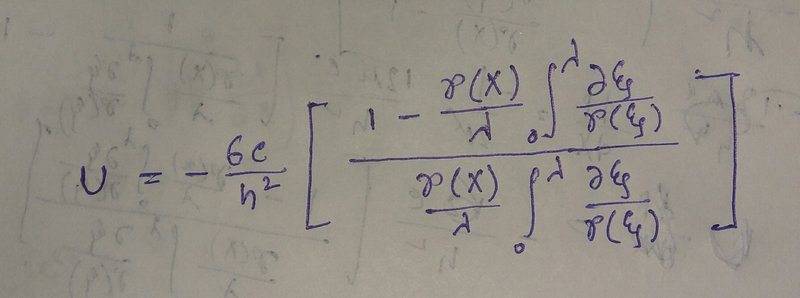

xi is a constant of integration to help us remember (in our subsequent analysis) that the value of the integral is a constant, independent of X. Please factor the c out of the brackets in this equation (it hurts my eyes).
The next step is substitute this expression for dP/dX back into our equation for U(X,T) in post #16 to get our final result for U. What do you get?

Chestermiller said:xi is a constant of integration to help us remember (in our subsequent analysis) that the value of the integral is a constant, independent of X. Please factor the c out of the brackets in this equation (it hurts my eyes).

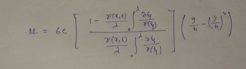

I get the following: $$U(X,Y)=6c\left[\frac{1-\frac{\rho (X)}{\lambda}\int_0^{\lambda}{\frac{d\xi}{\rho(\xi)}}}{\frac{\rho (X)}{\lambda}\int_0^{\lambda}{\frac{d\xi}{\rho(\xi)}}}\right]\left(\frac{Y}{h}-\left(\frac{Y}{h}\right)^2\right)+c$$big dream said:
As reckoned from the laboratory frame of reference, what does this give for u(t,x,y)?

Excellent. Now the only thing left to do is to determine the vertical velocity V. Any ideas?big dream said:

If you're asking how to differentiate this with respect to X, everything in the expression is constant except ##\rho (X)##big dream said:we could use the continuity equation. But I don't know what to do with this View attachment 215538

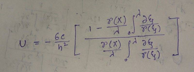

Yikes! That's nothing like what I get. Here is my development:big dream said:$${\it mambiguous} \left( V =~\left(-\frac{3\cdot c \cdot Y ^{2}}{h }+

$$U(X,Y)\rho(X)=6c\left[\frac{1-\frac{\rho (X)}{\lambda}\int_0^{\lambda}{\frac{d\xi}{\rho(\xi)}}}{\frac{1}{\lambda}\int_0^{\lambda}{\frac{d\xi}{\rho(\xi)}}}\right]\left(\frac{Y}{h}-\left(\frac{Y}{h}\right)^2\right)+c\rho(X)$$So,
$$\frac{\partial (\rho U)}{\partial X}=\left(1-6\frac{Y}{h}+6\left(\frac{Y}{h}\right)^2\right)c\frac{d\rho(X)}{dX}$$
So, $$\frac{\partial (\rho V)}{\partial Y}=-\left(1-6\frac{Y}{h}+6\left(\frac{Y}{h}\right)^2\right)c\frac{d\rho(X)}{dX}$$
So, $$V=\left(-\frac{Y}{h}+3\left(\frac{Y}{h}\right)^2-2\left(\frac{Y}{h}\right)^3\right)\frac{ch}{\rho(X)}\frac{d\rho(X)}{dX}$$

In post # 35, ##\rho(t, x)=\rho_0\left(1-\beta \Delta T \cos{}\frac{2\pi(x+ct)}{\lambda}\right)## and
$$\frac{1}{\lambda}\int_0^{\lambda}{\frac{d\xi}{\rho(\xi)}}=\frac{1}{\rho_0}\frac{1}{2\pi}\int_0^{2\pi}{\frac{d\theta}{(1-\beta \Delta T\cos{\theta})}}$$
