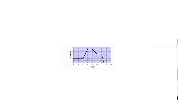

A velocity of a runner is described in the graph below. The runner started from X=0 on the X axis. In what distance from X=0 (beggining) will be the runner, after 11.5 sec.
Please tell me why it isn't 42m.:confused:
V=m*s, so that means the area of the graph gives us the distance from X=0. then;
32(the 2*1 areas)+ 4 (the first triangle) + 2 (the second triangle) (from X=0 to 10. sec)
now calculate the +1,5 sec area which is 1,5*4=6
then 38+6=44, right?
Thanks goktr001, but i have just solved it, its actually 44.
I summed the area under the graph, but only till the 11sec, i didnt notice that 11.5 is actually 3 quarders of triangle.
Problem solved anyway. thanks.
