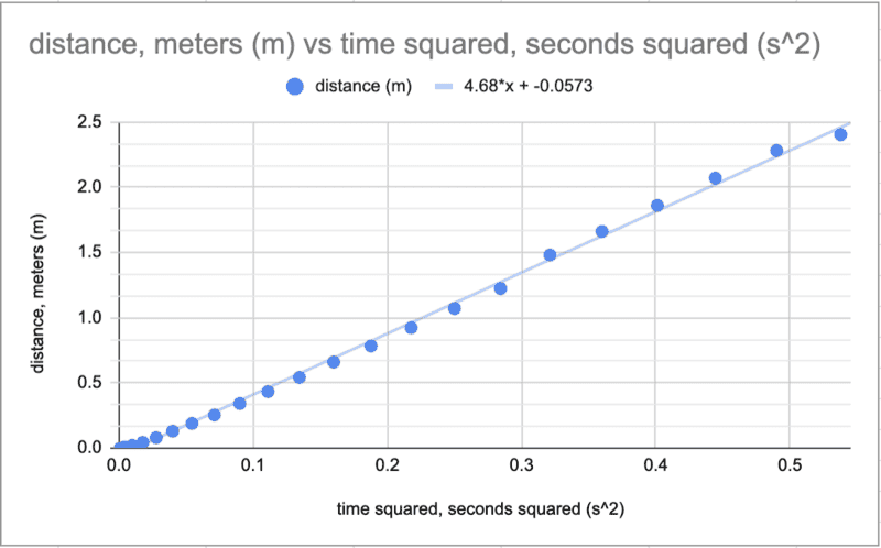

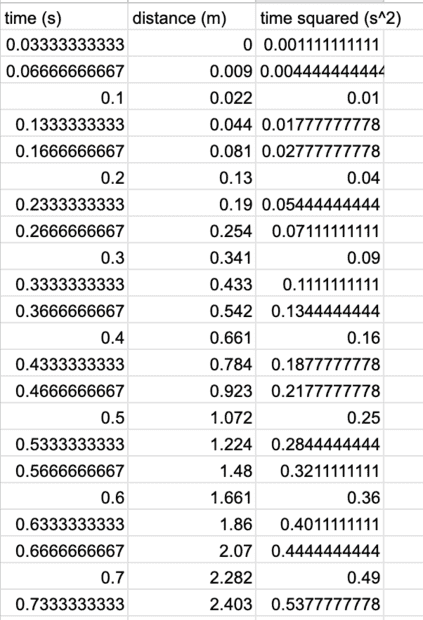

Hi! I'm doing a lab where my class is verifying the acceleration due to gravity. We dropped an object and recorded the time with a spark timer, then measured the meters every 1/30th of a second. So, I have distance (meters) and time (seconds). THEN we square the time, and plot that on a graph of dist. vs time^2. But my slope is only roughly half of gravity??? isn't the acceleration supposed to be equal to gravity?
s=ut+1/2at^2
Data and graphs here (the time is measured every 1/30 of a second, but for some reason, Google Sheets thought 1/30 wasn't a number so its in decimals!!! very confusing!!! so sorry about that!). why is the slope only 4.68, should it not be 9.81m/s^2? is the slope of m/s^2 not supposed to be acceleration due to gravity? is my data weird? thanks!

In your experiment, s = (1/2)g t2
After your conversion and plot, your graph is similar to following equation.
y = (1/2)g x .... general equation of a straight line.
Slope is therefore (1/2)g, .... there's nothing wrong, right?

In your experiment, s = (1/2)a t
You mean s = (1/2)a t2. Then x = t2 in the straight line plot.

Now that your question abut the slope has been answered, how do you explain the intercept of about -6 cm? You need to address that question in your report and it seems that you already have the necessary information to do just that.

yeah, I also noticed that the intercept was off and makes no sense. My physics teacher (who has 0 background in physics because the previous teacher quit a few days before school started) made us measure it like that. I really wish I had an actual teacher.

Please don't blame your teacher. You can figure this out on your own because it's your doing. Look at your data. No intercept means that at t = 0 the object is at distance = 0. Your table shows that distance = 0 at time t = (1/30) s.

A clue to the source of plot problem:
Note that the plot shows minor variations from a straight line at times
0, 0.3, 0.55. That repetition at similar intervals make me suspicious that the either the Time or Distance measurements (or both) may have a systematic error.
Don't expect your test setup or equipment is always perfect. I think @kuruman is hinting at that possibility.
