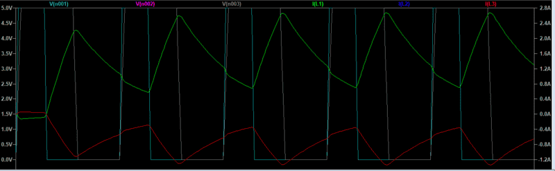

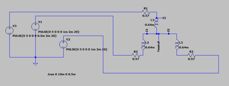

I want to create circuit and confirm the sum of the three currents is 0
I always think of simulating the inverter phase currents
as a first step i have created the above circuit and i want to verify the currents at Neutral is 0. But it does not add to 0 as the result

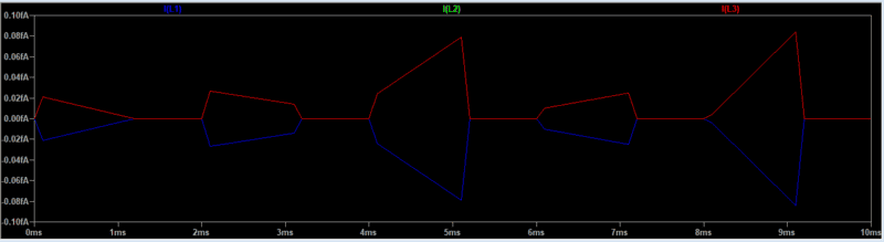

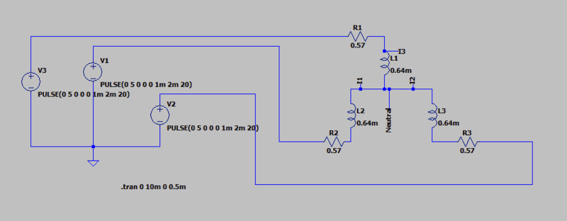

Turn the inductor's polarity dots on, and you will see that L1 is backwards in the circuit compared to L2 and L3. The inductor currents then total less than 1 fA, which for me, is close enough to zero.
The three pulse sources are identical, as is the neutral voltage.

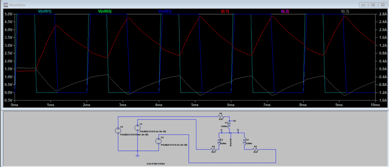

Another simulation with different duty cycle. It adds upto 0.
I must take your word for it.
I'm unable to read the picture, or run the .asc

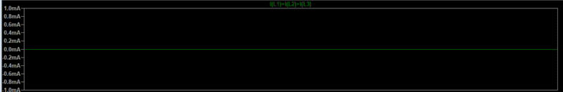

Since neutral is floating, the sum of the three currents must be zero.
Edit a plot to show the value I(L1)+I(L2)+I(L3)
Sorry i am not sure the asc file is not running, through dos i renamed to txt and attached.
Mosfetsim3.asc runs OK.
Yes I saw they were the same. Didn't he want three-phase as in, 120° phase shift from each source?
@boB_K7IQ
The schematic became 3PH later in Mosfetsim3.asc in post #5.
