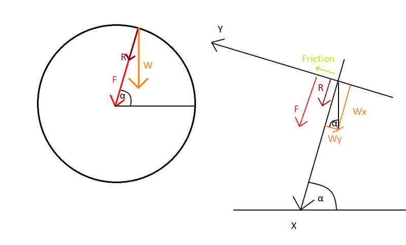

We have an object rotating inside a circular container. The rotation is vertical (see picture below).
The radius r of the container is given. Find the frequency (which then ties back to finding the centripetal acceleration) necessary, so that the objects rotating inside the container will fall down once they form a fixed/given angle α with the horizontal plane (the angle is 70°).
Force (centripetal) = m*acceleration (centripetal)
Centripetal acceleration = v2/r

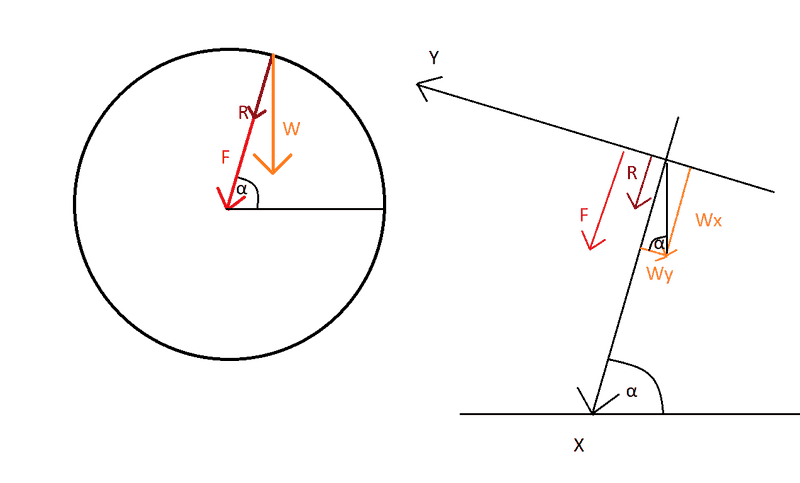

I tried drawing the free-body diagram, and this is my best attempt:
F = centripetal force
W = weight force
R = reaction force
At first I actually thought of putting R (reaction force) perpendicular to the surface, i.e. in the same direction as F, but things just didn't add up. I watched several videos on this topic, and most of them just talked about "convenient/easy" positions inside the circle (at the very bottom, at the very top, or at "3/9 o'clock"). Just one video mentioned intermediate positions, which is the case with this problem.
That video said, and that's the way I've set up the problem, that you need to "deduce" the position of R (so R is NOT perpendicular to the tangent to the circle in the point where the object is), knowing that the sum of all forces must be equal to F. So I tried my best doing an accurate drawing, using the geometric vector sum rule (the parallelogram thing), summing F and -W to "deduce" R in the drawing.
I was then going to proceed summing the X and Y components to happily solve for a, and then I got stuck because I can't find any way to obtain the green angle in the figure, which seems necessary to calculate the Rx and Ry components.
The axis I was going to choose were +X axis in the same direction of F, and then +Y perpendicular to it and pointing "northwest" (up and left). That would have given me:
Y axis:
Ry - Wy = 0
X axis:
Rx + Wx = m*a
But, again, I can't seem to find the green angle to use for Ry and Rx.

Hello Alex,
At first I had trouble forming a picture of what is happening. Looks like a washing machine or something. The 'objects' are stuck against the inner wall of the cylinder, and if the whole thing doesn't rotate fast enough they will get unstuck. The objects indeed rotate, i.e. follow a circular trajectory (the black circle in your picture). You worry about R but can you save yourself the troubl: As soon as W can't "deliver" the vertical component of F, the objects come loose from the wall.

It's wrong in the FB diagram. Your initial hunch was correct - it's always perpendicular to the surface of the rim.

So, new diagram with R perpendicular.
When I originally attempted this, I set the equations and they were:
X axis:
R + Wx = m*a
Y axis:
-Wy = ?
As anticipated earlier in this post, I thought there must have been something to add to Wy so that the sum would be = 0, and I speculated it could have been friction. But there is no mention of friction (or lack thereof) in the problem, so even if I assumed there was friction I would still have the issue of having three unknown data but only two equations (R, a, and the additional coefficient of friction).

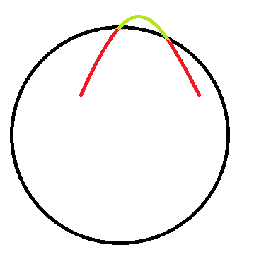

PeroK said:
Gravity has a bad habit of slowing things down as they move upwards!
Now that you mention it, yea...is it not uniform circular motion anymore?

@Alex126 sorry, this is all a bit muddled now. But, the reaction force cannot be perpendicular, because there is a tangential component of gravity. So, there must be friction to keep the ball in place.

Isn't this what I did in post #10 of the topic? With "radial" Normal force, and the "centripetal axis" as +X, it was:
+N +W_x = m*a
Or, with vertical +Y axis instead:
+mg +N_y = F_y
So "once N_y goes below zero the object detaches" should mean:
mg +0 = F_y
=> mg = m*a * sin(α)
=> g = a * sin(α)
=> a = g / sin (α)
Which ties back to all the previous attempts I made, and ends up with frequency of 0.91 instead of 0.85.

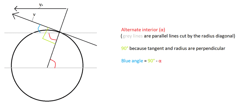

Below is my previous post (updated a bit), my "final" body diagram thingy, and as-complete-as-I-can-fathom last considerations. If someone could read through and tell me if I made any mistakes down below, I'd appreciate it:
Alex126 said:
IF the problem had given me the value of μ (friction coefficient), would you still interpret the problem the same way, or would you do the X and Y equations separately? So for instance, with "centripetal axis" as +X:
X axis:
N + W_x = m*a
N + mg*sin(α) = m*a
Y axis (positive up and left):
+Friction - W_y = 0
=> N*μ - W_y = 0
=> N*μ - mg*cos(α) = 0
Full drawing:
From this setup, I would do:
X axis:
N = m*(a - g*sin(α) )
Y axis:
(plug the N from X axis in)
m*(a - g*sin(α) )*μ - mg*cos(α) = 0
=>(a - g*sin(α) )*μ = g*cos(α)
=> ##a*μ = g*sin(α) + g*cos(α) / μ##
So the value of ##a## depends on a fixed part (##g*sin(α)##) and a μ-dependent part (##g*cos(α) / μ##) which becomes smaller and less significant the greater the value of ##μ## is.
If all of what I just said is true, by proceeding "backwards" from the theoretical solution of 0.91 rounds/second, I've tried to deduce ##μ##:
##v = 2 π r * f## (f = frequency) = 1.83 m/s
##a = v^2/r## = 10.46 m/s2
From the X axis equation:
Plugged into the Y axis equation:

Alex126 said:
Alright. I still am not entirely convinced though; it kinda feels like we are making the most out of what we have, but we are missing a necessary piece of information (μ) which would be needed for a proper solution. As I mentioned earlier, IF we had the friction coefficient (maybe in a different problem) would we be proceeding differently?
With a finite coefficient of friction, the object must start to slip before it falls off. The object falls off when the normal force reaches zero, but it starts to slip when ##\mu F_N < mg \cos \theta##. Which must happen before ##F_N = 0##.
That's why you have to assume infinite friction. Or, less dramatically, than friction is great enough that the slipping occurs only a short distance before it falls off and makes a negligible difference to the object's velocity: i.e. the object continutes to move approximately with the cylinder until it falls.
Your calculations for ##\mu## are not valid, as ##F=0## at the point at which you appear to be calculating it!
In general, I would say there is a lesson to learn from this:
An FBD is valuable, but you must be prepared to think about the problem before/after you draw one. You made this complicated not because you drew the FBD first, but because you didn't simplify it (without the normal force and friction) once you had sussed out the key that ##F_N =0##.
You still don't seem happy to solve the problem using the insight into its solution, but insist in retaining variables that can be dispensed with. This is not all bad, but you should learn from this that if a problem can be simplified, then simplify it.
Likes Bandersnatch
As I see it contact forces such as friction and reaction can be ignored in this problem. See post 19. Falling begins at the instant contact is broken and so the contact forces become equal to zero at that instant. The only force maintaining momentary circular motion at that instant is the component of W towards the centre. In other words the centripetal acceleration is given by gsin70.
Yes, but only after supposing the frictional coefficient is effectively infinite, as PeroK points out.
Alex126 said:
mg = m*a * sin(α)
No. At the point of detachment the net acceleration is vertical. If you break that into radial and tangential components, the tangential component is nonzero but is missing from your equation.
This wrong equation led you to the erroneous 0.91 answer and thus to a relatively modest 2.7 for the coefficient of friction. With the correct ≈0.85 answer the coefficient of friction becomes huge (in fact, infinite).
Since you do not care about the tangential acceleration, simpler to resolve gravity into tangential and radial components: mg sin(α) = marad.
Likes Alex126
Yea, but I'm better at solving things when I understand them than when I have to accept an "insight" that falls out of the schemes I'm familiar with. I guess I try too hard to make things fit into a pre-made picture that I have of the problem, and thus find it hard to "adjust" to different scenarios. It's not that I don't "trust" what you guys are saying of course (quite the opposite, I'm trying to learn), it's more that in my mind this problem seems to be missing something and I'm trying to prepare for when I encounter a different problem which has all the variables that (in my mind) are needed, and then apply it to this particular case. Hence my attempt to figure the coefficient "backwards" from 0.91. Which I understand is wrong because of this:
PeroK said:
With a finite coefficient of friction, the object must start to slip before it falls off. The object falls off when the normal force reaches zero, but it starts to slip when μFN<gcosθμFN<gcos⁡θ\mu F_N < g \cos \theta. Which must happen before FN=0FN=0F_N = 0.
So basically the problem with what I said in my previous post is not in the calculation itself, but in the fact that while the calculation is correct "at the end" it has a problem "before" the end (the point when the object falls) because a finite 2.7 coefficient will cause slippage before falling has a chance to even happen.
I'm curious what the coefficient would be (if there is a finite answer) if I take in consideration that fact too though.
Anyway. If I encounter this problem again I'll follow this kind of reasoning then:
1. Do the diagram.
2. If I notice that something seems to be missing (in this case, the tangential component of Weight is not counterbalanced by anything, although Friction could be implied) I will assume that there is an implicit "something" (and hopefully "Friction" can fit the role) that does the job, silently in the background. I then assume that this "something" is "big enough" that it will do its job regardless of its actual value.
3. Given that the tangential part is automatically taken care of, the only part that is still needed will be the radial component.
The only problem I have with this whole thing is understanding the part where you all say "N = 0" (which then leads to: Wradial = m*a). Even after this whole topic, I would still put this equation instead: Wradial + N = m*a. Of course if N = 0 then I get what you are all saying the equation should be, but I don't get how we deduce that N = 0 from the fact that the object falls down. I sort of understand it if I think about an object hanging on the ceiling, in which case if N = 0 (or generally N < mg) then the object would fall down to the ground.
So here, in a similar fashion, once N = 0 then we can find a critical value of a so that the object falls off, because basically before that point N "helps" Wradial in forming m*a, but after that point Wradial is all alone and it's not enough anymore. For instance, with an angle of 60° we should have (radial axis):
+N + Wrad = m*a
With the a found previously (a = 9.128), and Wrad being m*g*sin(α), the N here would be:
N = m*(a-g*sin(α) ) = m*0.632
With α of 50° N = m*1.612, and so on, with N increasing as the angle becomes smaller, i.e. Wrad provides less and less contribution (to the centripetal force) as the angle gets smaller, whereas N provides more and more contribution as the same thing happens. On the opposite end of the spectrum, as the angle increases we have bigger Wrad and smaller N. The biggest value of Wrad is m*g (at 12 o'clock), but that comes after the smallest value of N (in this particular problem, and with the acceleration found before, that is), so the point of detachment happens when Wrad reaches a certain value that alone is not enough to provide centripetal force anymore.
So, basically, as we move from angle 0° to 90° we have these two components, Wrad and N, the sum of which is constant and is always equal to m*a. As the angle increases from 0° to 90°, the contribution from Wrad increases while the one from N decreases, so we have a situation like [contribution from Wrad + contribution from N = m*a] 0+10 = 10, then 1+9 = 10, then 2+8 = 10, then 3+7 = 10, [...], 9+1 = 10, 10+0 = 10. Past this point the Wrad COULD still increase, but the fact that N has reached 0 means the object falls off. If we had a higher "sum result" (higher m*a, so higher a), then the situation would be like this instead: 0+12 = 12, 1+11 = 12, [...], 12+0 = 12. So in this second case what happens is still the same, but it takes a bigger angle before we get to the critical point where N = 0, so the object falls off later (or doesn't fall off at all if we make it past the 12 o'clock mark, which is the "hardest" point).
Therefore, asking if the object can complete the whole lap would be like asking "can we get to an angle of 90° before N reaches zero?".
So the core idea here is not really about the centripetal force, but the fact that the object falls really depends on "when do we get to N = 0". It's basically a race "against the angle", a matter of how far we can go before our "timer" (the ever-decreasing value of N) reaches 0. So that's the critical point that matters, that's the real question: "knowing that the object will fall when N = 0, and this happens at an angle of 70° in our case, what's the value of Wrad [since it's the only other component in the "sum"] at the point when N = 0?".
If this way of interpreting the problem is correct, I think I get it now :D
Alex126 said:
I tried following up, with the numbers, and the numerical solution I get is quite close to the number the textbook says, but it's a bit off. I kept rounding to a minimum, so the discrepancy (+0.06) in the final result shouldn't be there (0.91 vs 0.85).
Which of the two answers is supposed to be correct? Using my reasoning (see post above) I calculate f to be 0.85.

I am considering the instant when contact forces reduce to zero. At an infinitesimally small time before that instant contact forces will be infinitely small and the majority of the centripetal force will be provided by the inward component of the weight. At an infinitely small time after that instant detachment will be complete and the initial free flight path of of the object will be in a direction tangential to the circle at the point of release.
  • #32
of course not: there's something in the way: the drum.

I think I know what you mean Bvu ( post 32) but let me clarify. For something moving in a circle the instantaneous velocity at all instants is tangential to the circle. The same applies to the situation discussed here so at the instant of disconnect the instantaneous velocity is tangential to the circle. However the object will not be able follow a parabolic path because as you said the drum gets in the way. I should not have used the term "free flight path".
