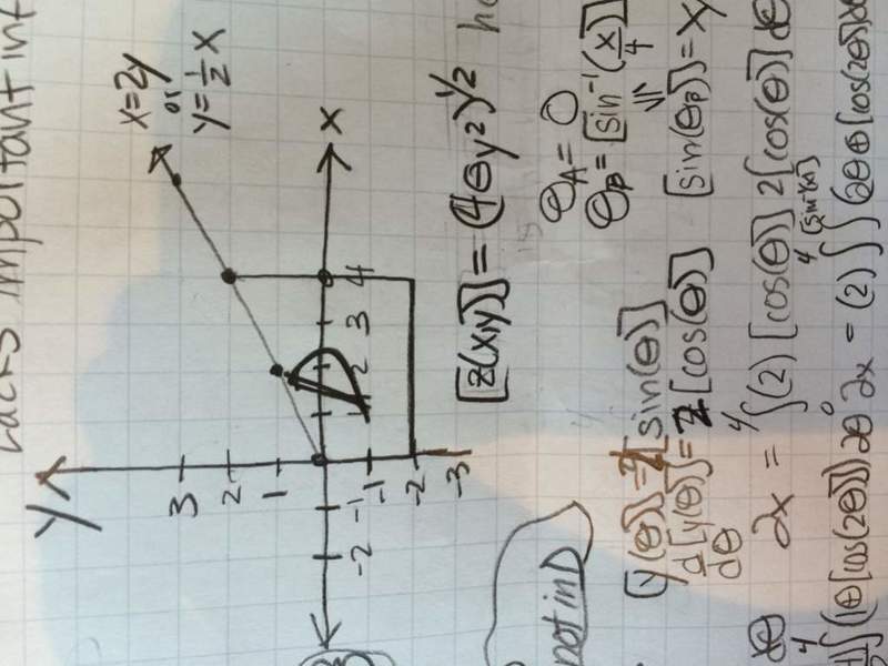

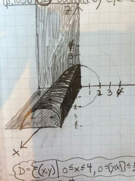

Must double integrate using type I or type II planar region D to find volume bounded by
Cylinder y^2+z^2=4
And
Planes
X=2y
X=0
Z=0
Hand-drawn 3D sketch of a solid with axes x, y and z, showing a curved cylindrical wedge over a rectangular base; axis ticks labelled 1, 2, 3, 4 and the handwritten domain D = {(x,y) | 0 ≤ x ≤ 4, 0 ≤ y ≤ ...}.

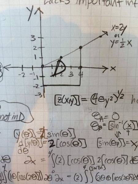

Handwritten sketch of the x-y plane showing the line x = 2y (y = x/2) through the origin, a semicircular region bounded by a curve near the origin, and a rectangle with corners at x = -2 and y = 4, with handwritten integral setup and trigonometric equations beside it.

The two pictures include my attempt at the answer.
What else would you like? The problem is stated very succinctly in the textbook as post 1 without more or without fewer words.
The pictures are my attempts at deriving the answer to this NOT simple problem.
I wish to double check my answer and see if there are additional ways without using polar coordinates to get to the answer.

Double integral (4-y^2)^.5 dy dx from x=0 to 4 and y=-2 to x/2
You're going to have to look at picture to even make sense of the scribbles I wrote above. So no more complaints.
You have totally ignored the comments about this image being sideways.
Handwritten sketch of the xy-plane with axes labelled x and y, a line y = x/2 or x = 2y drawn through the origin, a shaded region with a curved boundary, and a rectangle marked 2, 3, 4 along the axes; beside it are handwritten integral setups including [cos(theta)], sin(theta) and an integral from 0 to pi/4.
