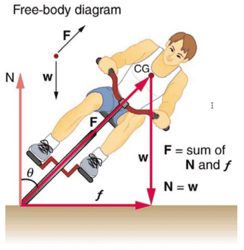

  • #36
erobz said:
In the vertical wall case (horizontal rider), what force is balancing the torques about the point of contact?
The rider has to incline at an angle to the horizontal as shown in this diagram:
https://www.scienceabc.com/wp-conte...oads/2015/10/force-acting-on-a-bike2.gif-.gif
(which is from this site: https://www.scienceabc.com/pure-sciences/science-behind-the-wall-of-death.html)
In the rider’s (non-inertial, rotating) frame of reference, the (fictitious) centrifugal force, acts through he centre of mass, providing the necessary torque to balance the torque from the weight.
In the ground (inertial) frame of reference, it’s harder to explain - so I’ll leave it to someone else!

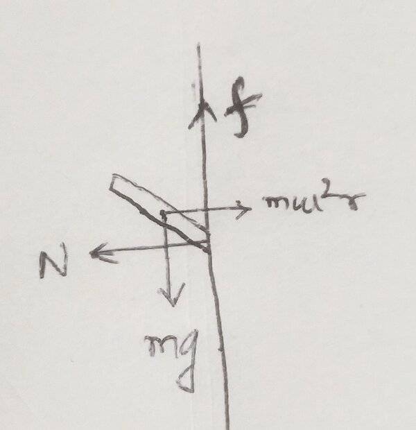

  • #39
Has anyone considered the torque due to the car center of mass not being right at the wall and how that impacts the problem?
  • #40
For the bike case, the bike is angled so that the net reaction from the wall passes through the mass centre. For the car, the same can be done except that it is limited by the angle the mass centre subtends to the wheelbase each side. If a vertical through the mass centre falls below the wheelbase there is a minimum speed to avoid rolling, and if a horizontal through it passes above the wheelbase there is a maximum.
  • #41
I would like to understand this further...
The bike is definitely angled, as I've seen in the videos and pics available on internet. But, I'm still trying to figure out how to understand it. When an object is on an incline, the reaction force from the surface is Normal to the surface. However, presently we are discussing about the situation when the wall is perpendicular to the ground. In post#40, you've mentioned that net reaction from the wall passes through the mass center. Could you kindly clarify what constitues the net reaction from the wall. I am assuming that one is the Normal reaction from the wall(which is normal to the surface of the wall), another is friction (acting upwards). Would the vector sum of these forces is the net reaction from the wall that you had mentioned in post #40 above.
  • #42
The bike is definitely angled, as I've seen in the videos and pics available on internet. But, I'm still trying to figure out how to understand it. When an object is on an incline, the reaction force from the surface is Normal to the surface. However, presently we are discussing about the situation when the wall is perpendicular to the ground. In post#40, you've mentioned that net reaction from the wall passes through the mass center. Could you kindly clarify what constitues the net reaction from the wall. I am assuming that one is the Normal reaction from the wall(which is normal to the surface of the wall), another is friction (acting upwards). Would the vector sum of these forces is the net reaction from the wall that you had mentioned in post #40 above.View attachment 318564
I have to be careful with the wording here. A force is more than just a vector; it also has line of action, which vectors in general do not have. Likewise, the net force of a collection of forces is more than just their vector sum. Its line of action is such that it has the same net moment about any given axis.
So I would rather say the net of normal and frictional forces passes through the mass centre. Were it not to, there would be a net moment about the mass centre.

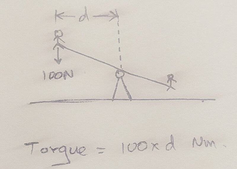

Can I add this...
NTesla said:
But what are we gaining by defining line of action as distinct entity from vector..?
We are gaining the ability to calculate a torque.
For example, you have a force of 100N acting left. You know both the magnitude and direction.
What torque does this force produce about the origin?
The question can't be answered because you don't know the force's line of action (or, equivalently, you don't know a point in space through which the force acts).

  • #52
NTesla said:
I'm assuming that you are brining the situation of seesaw.
No. My point was totally general.
In analysing the wall of death we use information about the line of action (LoA) of each force - though you may not have realised it!
The LoA of the weight is vertical and acts through the rider’s centre of gravity (which is, in a uniform gravitational field, the same as the centre of mass).
The LoA of the friction is vertical and acts through the effective point of contact between wheel and wall.
The LoA of the normal reaction of the wall on the rider is horizontal and acts through the effective point of contact between wheel and wall.
The LoA of the (fictitious) centrifugal force is horizontal and acts through the rider’s centre of mass.
Without this information, the question can’t be answered because torques could not be determined. For example, if you incorrectly assume that the (fictitious) centrifugal force acts through the point of contact between wheel and wall, the problem can't be correctly solved.

  • #56
Minor quibble here. You were careful to note that the center of mass and the center of gravity may not coincide in a non-uniform gravitational field.
The centrifugal force is non-uniform.
I am not sure what alternative turn of phrase to use for the relevant notion. Perhaps "center of centrifugal force". That center would be defined as the point, located on the line of action of the net centrifugal force, that makes ##F=\frac{M_\text{tot}{v_\text{cocf}}^2}{r}## hold true. Thus making the corrected statement a tautology.
  • #57
NTesla said:
(1) Would it be right to say that the term net reaction from the wall is the vector sum of normal reaction and friction as both originate at the point of contact of the tyre and the wall ?
Yes.
NTesla said:
(2) What is the reasoning for which haruspex said that it(net reaction from the wall) must pass through the centre of mass of the rider in case of bike ?
The bike has no angular acceleration about its centre of mass. Therefore there is zero net torque about its centre of mass. Since the weight and (fictitious) centrifugal force pass through the centre of mass, the requirement for zero net torque tells us that the net reaction from the wall must also pass through the centre of mass.
This is useful as it gives a way to find the angle of the line joiing the point of contact and bike+rider's centre of mass.
NTesla said:
(3) Can we not take the forces individually as i have pictured it in my post#41 and then calculate the torque due to all forces about the point of contact of the bike's tyre on the wall and then equate that torque to zero. Wouldn't that give the right answers.
Yes. That's a perfectly good way to do it. Note that the only forces producing torque about the point of contact are the weight and (fictitious) centrifugal force.
EDIT: But of course you need to know the distances ('lever arms') in order to find the torques.
