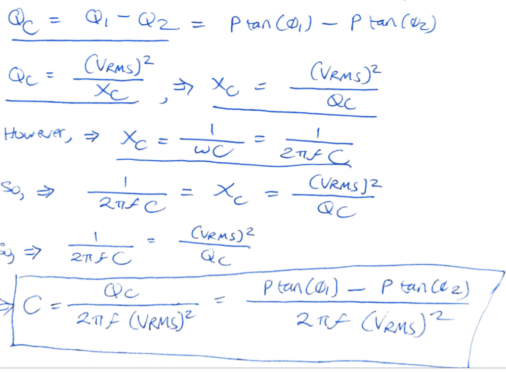

the full question meant to read:
A 50 kW load operates from a 60 Hz 10 kV rms line with a power factor of 60% lagging. Determine the capacitance that must be placed in parallel with the load to achieve a 90% lagging power factor.

I see. Then, in that case, you just need to change the ending of your method. You need to equate the two equations of "XC" (Finding the reactance that's coming from the capacitor). I attached the derivation of that in the Equations.PNG file. The reason for this is because your "Active Power" (P) is not changing when you change the Power Factor. However, your "Reactive Power" (Q) is changing with the different Power Factors.
Capacitors supply reactive power "Q" to the circuit. Therefore, you need to use the "change in reactive power" to calculate the capacitance value needed to supply that amount of "Q".
