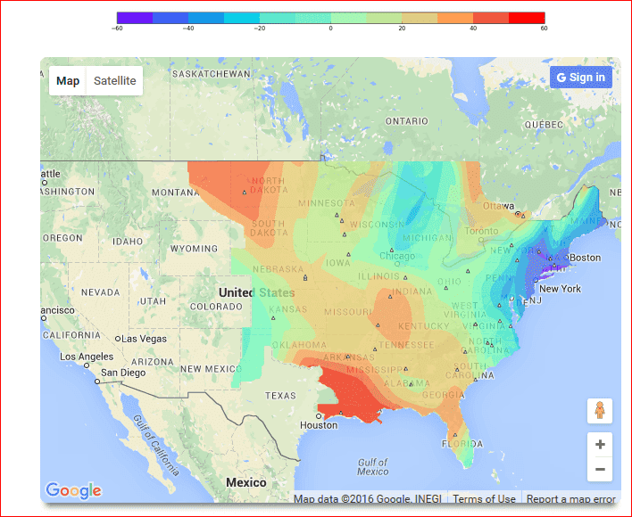

You can watch here the minute frequency changes across the whole US grid as energy sloshes around. It swings like a wind chime.
http://fnetpublic.utk.edu/gradientmap.html
Bear in mind that map isn't perfect it always shows far west running slow. I don't know why . But short term variations are evident.
I prefer this one showing the phase angle. Blue areas are importing power from red areas. But it doesn't cover "Way out West".
Watch it for a few minutes... it's fascinating.
http://fnetpublic.utk.edu/anglecontour.html

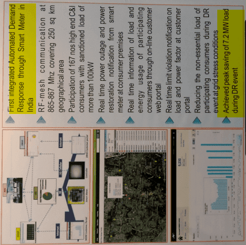

Thanks for your reply. Now i agree that no extra energy is generated.
But recently i went to a conference. They put these statement like "Achieved peak savings of 7.2 MW load during DR (Demand Response) Event"
What do they mean by peak savings of 7.2 MW mean? If Produced energy is same as consumed energy where is the saving? Is is commercial savings they are talking about? Meaning they committed to purchase more power but now they reduced it to 7.2 MW because of Demand Response?
Sorry one more question. If utility orders Energy say tomorrow we want 1000MW, are they obligated to buy even thought they have supplied less because of consumption?
I read that as meaning that the 7.2 MW was handled by lower cost generators. High cost, Peak Generation capacity was not needed. Presumably this could be achieved by stoking up coal boilers in good time to catch the peak demand. You can do this with software if you have a sluggish system (predictive techniques) or with human skill and experience. Pedalling fast downhill (forward planning) can help get you up the next hill.

  • #34
Look at the bullet just above the one you yellowed..
I would guess they remotely switched off 7.2 megawatts of water heaters, airconditioners and clothes dryers.
http://energy.gov/oe/technology-development/smart-grid/demand-response
It also includes direct load control programs which provide the ability for power companies to cycle air conditioners and water heaters on and off during periods of peak demand in exchange for a financial incentive and lower electric bills.

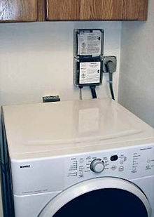

Wikipedia shows this picture of a clothes dryer using a demand response switch to reduce peak demand

i represented the company. My company does software.
I understood the usage of smart meters like to time of usage , if there ant defects in the meters, auto disconnect etc
But still i am not understanding how smart meters can help utilies save money at the distribution place.
Satish
But this as good as not switching the washing machine. So is it addressing financial problem or technical problem.
  • #37
I'm a power plant maintenance guy. So to me it's a technical problem.
At my utility there were days when customers use was pushing our ability to generate so close to the limit that we turned off lights on the boilers and cut out feedwater heaters just for a few extra kilowatts. We sure could have used some gas turbine peaking units but this was 1960's...
To a power company system dispatcher it's a financial problem. If he doesn't have to start one of those horridly inefficient gas turbine peaking units he can save thousands of dollars. 7 megawatts at ten cents per kilowatt for jet engine fuel is S700 an hour. At one time we had a hundred megawatts of those peaking turbines..
