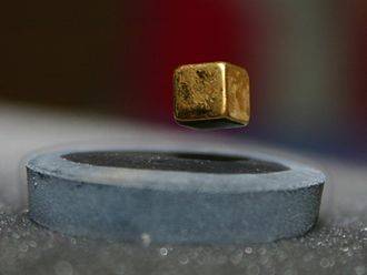

Oh.. I thought levitating trains used the Meissner effect.. and instead of levitating trains..they levitate particles in LHC. Reading this. http://supraconductivite.fr/en/index.php?p=applications-trains-maglev-more It's not so.
Can't trains or any locomotion use the above principles? https://en.wikipedia.org/wiki/Meissner_effect

kiki_danc said:
Oh.. I thought levitating trains used the Meissner effect.. and instead of levitating trains..they levitate particles in LHC. Reading this. http://supraconductivite.fr/en/index.php?p=applications-trains-maglev-more It's not so.View attachment 232123
But what does that have anything to do with directing the direction of the particles?
I can levitate trains using ORDINARY magnets! I do not need superconducting magnets, in principle. For many practical reason, I'd like to use superconducting magnets because I can use less current to create the same magnitude of magnetic field, AND, I have the added advantage of using Type II superconductors and flux penetration for mechanical stability.
But this has nothing to do with guiding the particles. So, to address your point, the Meissner effect has no bearing on guiding particles. I worked at a particle accelerator and we used ordinary electromagnets to guide these particles.
