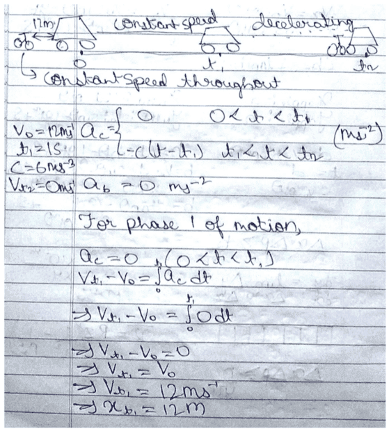

  • #45
I added the 12 seconds by mistake. I should have added 1 second for the phase where the speed is constant.
  • #46
PeroK said:
There are a few mistakes there. ##t_2 = 3s## is correct. The calculation of ##x_{t_2}## has gone wrong somewhere. You added an extra ##12s## for some reason(?).
I too feel I have gone wrong in that part.
  • #47
The way you did it, ##t_2## is the final time. You don't need to add anything.
