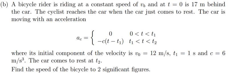

Find the speed of the bicycle using the given data to up to 2 significant figures.
I am not understanding how to proceed. I could use a hint for calculating the distance travelled by the car when the car is decelerating and then calculating the distance and speed of the bike will be elementary and can be solved easily. Thanks(or sorry for a possible mistake in phrasing or formatting my question) in advance.

You seem to have pasted in an image containing your work rather than having typed in your work directly. Let me transcribe it for you.
brochesspro said:
On integrating f(a) in the first phase where the v is constant (since the acceleration is equal to 0 m/s2, I get ##v_{t_1}## is equal to 12 m/s and ##v_{t_2}## is equal to 0 m/s (given). Also you get ##x_{t_1}## is equal 12 m after integrating the velocity function.
I agree that ##v_{t_1} = v_{t_2} = 12 m/s##.
I agree that ##x_{t_1}## is equal to 12 meters. This is 12 m/s multiplied by 1 s. That integration is trivial.
Given that starting point, what prevents you from writing down a formula for ##v(t)## that is valid for ##t_1 \le t \le t_2##?
Worst case, what prevents you from drawing the velocity/time graph on graph paper and counting squares?

I am supposed to use integration. I am unable to use an equation of motion using any three variables. I have ##v_0=12 m/s## and ##v=0 m/s##.
So, what precisely is stopping you?
It's not too hard. My suggestion is to simplify things by defining:$$a(T) = -cT \ \ \ (0 < T < T_2)$$ where ##T = t - t_1## That let's you calculate ##T_2## and ##x(T_2)## more easily. Then just add on the initial distance before the deceleration phase.

I am just having a problem in two things, namely:
1. How to find the difference ##t_2-t_1## to find the acceleration using equations of motion, or finding the acceleration directly using the given constant ##c##, and
2. Where and how to use the constant ##c##(for integration) .
I think it will be easy to use the equations of motion rather than use calculus.

If you mean SUVAT, they are only valid for constant acceleration. There's no alternative to calculus in this case.

Yes, you are right. I integrated ##f(a)## for the second phase by putting the values and got a quadratic equation and then I solved it and got ##t_2 = 3s##.
Also, I integrated the speed function (integrated ##f(a)## twice) and got ##x_{t_2} = 10 m##. How is that possible since the car is stopping while going forward and so ##x_{t_2}>12m##.

I have no access there. What was your answer for ##v_b##?
##2.6 m/s##

I thought the bicycle started ##17m## behind the car at ##t = 0##?
##26 m/s## would be a better guess.
