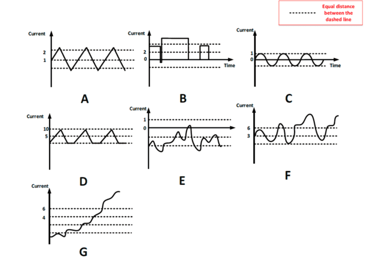

Which graphs represent different types of current flow?
In summary: Ah yes, it should be. Then number 4 will include graph C since it has an average of 0. Thank you for the lead.
jaximus
(1) Name the waveform(s) that represent a periodical current flow.
(2) Name the waveform(s) that represent a direct current.
(3) Name the waveform(s) that represent a non-periodical alternating current.
(4) Name the waveform(s) that represent a current with a non-positive average
Each letter can be used more than once or not at all. I find some graphs to be very tricky and confusing. For example, graph A looks like a direct current graph but it goes below the 0 line a little, causing me to doubt it. Graph E and G are very weird graphs for me as well.
No calculations required. Question only requires me to choose which graph fits which description.
My answers: 1) C, A, D
2) D, F
3) B, E, G
4) E

Hello, @jaximus . Welcome to PF.
You did well to use the "UPLOAD" feature for your image.
I find it helpful for the full image to be shown in the post rather than just showing the thumbnail image, but other helpers may disagree with me.
As for your answers, I agree with all but 4), which should have one additional selection.

As for answer 4.
If an average is zero, then it is non-negative, right?
SammyS said:
OK.
As for answer 4.
