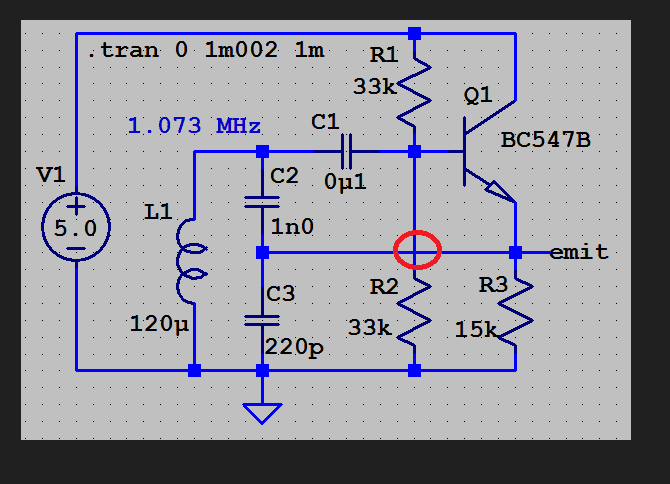

The multimeter certainly detects a voltage that oscillates between + 0.1 Volts and - 0.1 Volts at the antenna of my oscillator, although random values in this range at random times because cannot measure continously like an oscilloscope can,
while detecting + 2.5 Volts near the battery terminal. So I guess AC is present.
Perhaps the radio signal is too weak in Watts to be detected by the radio receiver. Perhaps static noise is stronger in Watts.

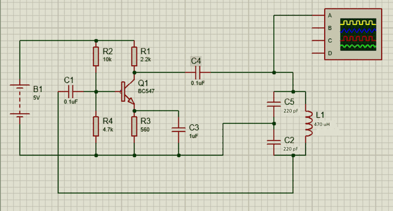

You must turn off the computer and perform the above test with the oscillator close to the AM radio antenna.
I found a similar experiment, where a Collpits oscillator is heard on radio at time 4:15 in the video. Perhaps my antenna is not impendance matched. But good news, my multimeter value oscillates even faster in values and polarity than before when I use two 3 V coin batteries on top of each other, giving an input voltage of +5.21 volts and an output AC voltage of between +1.35 and -1.35 Volts.

I have an idea though, what if I connect my headphones to the AC output of my oscillator? won't the AC be converted to audio?
  • #72
Some of us have been working with radio frequency systems for more than sixty years. We do not need to look at examples on YouTube.
Have you yet heard that quietening when your AM radio is tuned to your oscillator?

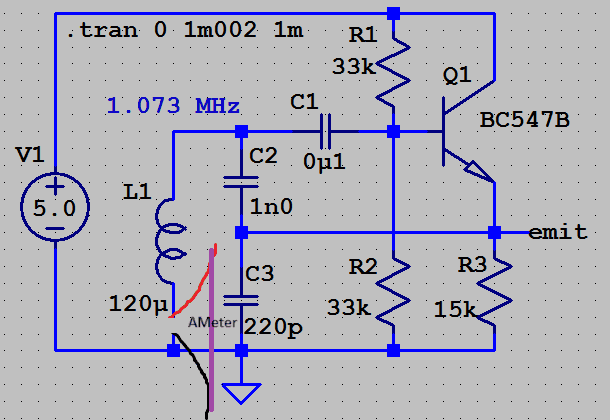

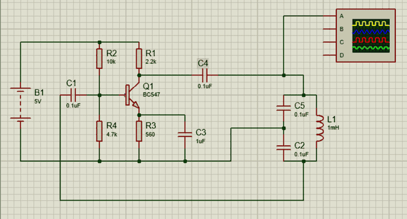

How does your simulation know that the negative of the battery is the ground reference?
If you are getting ± voltages on the inductor, then I guess you must be using a DC range on the meter to measure the AC.
You may not be aware that the inductor is floating, without DC bias, since every DC bias path is blocked by a capacitor. That might explain partly why your meter is confused.
Measure the DC voltage of the emitter and collector of Q1 to ground. That should identify if the transistor might be oscillating.
  • #79
Yes, every path from the battery to the antenna is blocked by a capacitor connected in series. DC voltage cannot pass through a capacitor connected in series. Why I think that? Because DC charges the capacitor then the capacitor stays charged and acts like an open circuit.
Only AC voltage can pass through a capacitor because it regularly charges and discharges the capacitor. The base of the transistor is connected in series to the capacitor C1, the collector to the capacitor C4 and the emitter to C3.
Am I wrong? Can DC voltage pass through a capacitor connected in series?

This sort of AM radio. But what IF I am using the wrong resistor values in the circuit, too low resistance, 56 ohms, 13 ohms, what if I need to use a lot higher? I thought a lot higher resistance would stop current from flowing at all.
  • #83
So, are you saying the diagrams you have supplied do not match what you have built?!!
That is sort of like putting a bicycle tire on a car and wondering why it always looks flat.
  • #84
While the oscillator will not work if the DC bias is too far out, resistor values are a red-herring. Your oscillator will produce sufficient signal for the AM radio, when you sit them next to each other. You just need to turn the computer off, and make an oscillator that operates in the MW band.
  • #85

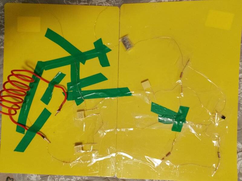

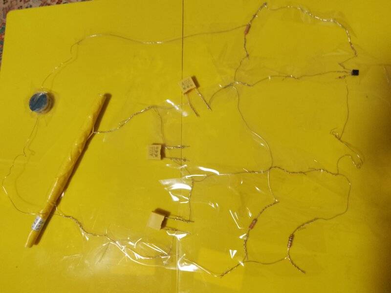

The component values you have used are a bit of a mystery.
It is important that you list the values you have actually used, before progressing.
The inductor value is critical. What is the value ?
The inductor you show in the photo, in post #47, just does not look sufficient for the bottom of the MW band.

Finally I have received on the AM radio, a sound beep composed of three sound frequency spikes: 1000 Hz, 2000 Hz and 3000 Hz. 1000 Hz was the loudest, 24 decibels louder than the rest of the spectrum. I have moved the circuit away from other devices to hear the beep on the AM radio, then a minute later I recorded the beep. Although the AM radio frequency was more driven towards 700 KHz (somewhere in the middle between 600 and 700) rather than 612 KHz. I guess that would be the 10% tolerance of the capacitors.
  • #87
The value is 1.35 uH but I cannot show it because it is covered in a yellow insulator tape. It has 37 turns, 0.4 cm radius and 6,4 cm length. I calculated it here: https://www.allaboutcircuits.com/tools/coil-inductance-calculator/
The capacitors have the code 104K which means 0,1 uF with tolerance 10% except for C3 which has 1 uF. All resistors have 56 ohms with exception for resistor R3 which has 33 ohms.
  • #88
James2018 said:
Finally I have received on the AM radio, a sound beep composed of three sound frequency spikes: 1000 Hz, 2000 Hz and 3000 Hz. I have moved the circuit away from other devices to hear the beep, then a minute later I recorded the beep. Although the AM radio frequency was more driven towards 700 KHz rather than 612 KHz. I guess that would be the 10% tolerance of the capacitors.
Any beeps or buzzes etc you hear IS NOT your oscillator.... its coming
from something else On your work bench.... probably the computer.
Which Baluncore has also told you to turn off.
Baluncore has told you multiple times that you need to tune the radio
carefully to find the quiet spot = the oscillator. If you don't find that spot then your oscillator isn't working OR it is on some far away frequency.
You need an oscilloscope else you will not figure out what is happening with your circuit.
You also need to start listening carefully to what people are trying to teach you and answer their questions instead of responding with random comments :smile:
Cheers
Dave
  • #89
Cheers
Dave
Yes, but I cannot find the quiet spot anywhere between 530 KHz and 1700 KHz. I did follow the online scheme for the Collpits oscillator except I used lower resistances. If it did work for the one who invented the scheme, why wouldn't it work for me?
  • #90
Then, as I said, either the oscillator isn't working, or if it is working, its frequency is outside of that range.
You need an oscilloscope to determine what your circuit is doing
