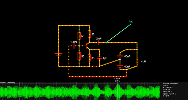

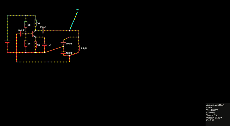

  • #34
This is what the simulation shows, a decaying oscillation when I disconnect the switch

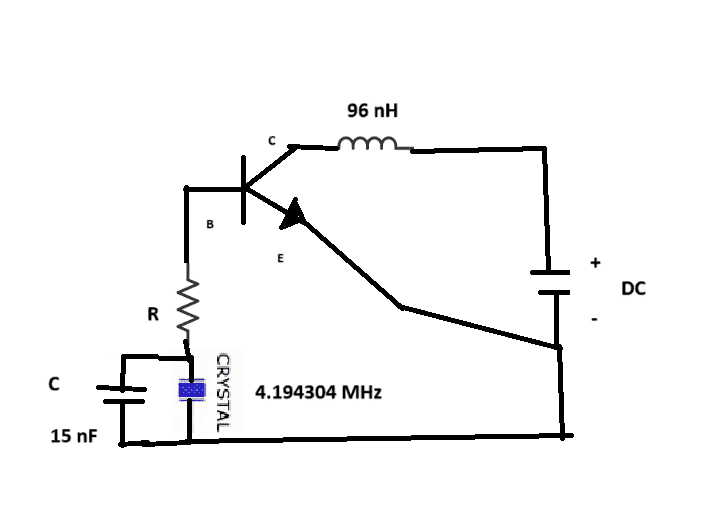

  • #35

  • #36
James2018 said:
Can this circuit sustain LC oscillations?
Probably not.
Without a circuit diagram, it is impossible to know.
Where did you find the 1000 MHz quartz oscillator? What part number?
You wanted to watch the compass change direction.
There appears to be no compass in the blurry picture.
  • #37
Baluncore said:
Probably not.

  • #41

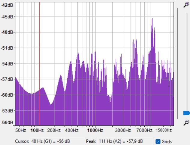

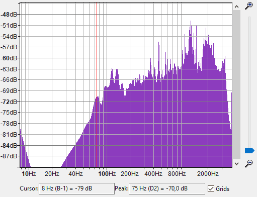

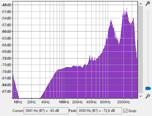

So the usual radio AM noise spectrum that sounds like white noise to my ears:
And its modification due to the presence of my circuit:
This is the second time I do the measurement and I find the same 793 Hz sound spike in the radio speaker. It sounds like a beep in my ears.

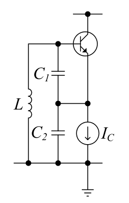

  • #44
Baluncore said:
There is no base current, so the transistor will not turn on, and the circuit will not oscillate.
You are free to add to the circuit diagram if you want. I connected the base terminal and the emitter to the negative battery terminal and the collector to the positive one. I do not know what else to do.
My inspiration was the common-base Colpitts circuit. The inductor L and the series combination of C1 and C2 form the resonant tank circuit, which determines the frequency of the oscillator. The voltage across C2 is applied to the base-emitter junction of the transistor, as feedback to create oscillations.
https://en.m.wikipedia.org/wiki/Colpitts_oscillator
Maybe the beep on the radio antenna is from other circuits found in my room.

  • #46
Baluncore said:
You got a diagram with a simplified bias circuit.
At the bottom of this section is one with the bias circuit.
https://en.wikipedia.org/wiki/Colpitts_oscillator#Theory
But the multimeter measures 2 Volts (sort of a varying value between 1.96 and 2.2 volts) at the terminals of the quartz crystal. And, there is a beep when I place the radio receiver antenna on top of the quartz crystal. I moved the circuit away from other circuits on my terrace and the beep is still heard on the radio when the antenna is on top of the crystal and not heard when the radio receiver antenna is moved away.
Remember, the base of the transistor and the emitter are connected using different wires to the negative terminal of the battery, while the collector is connected to the positive terminal.
Still, I am going to dissasemble it and build it differently to make sure it works.

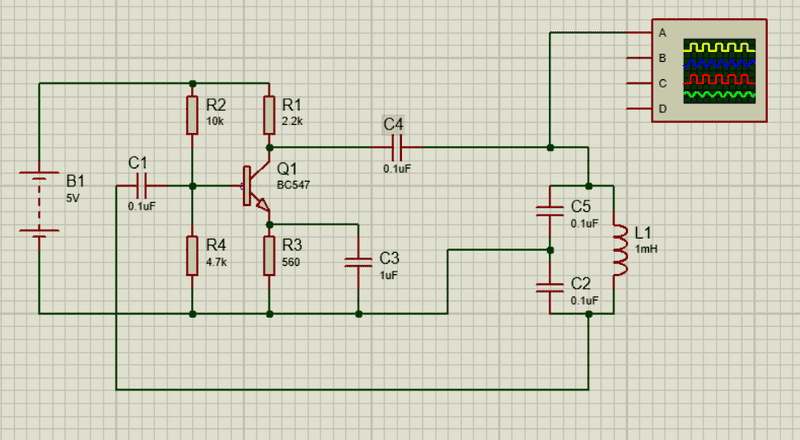

  • #47
I followed this Collpits oscillator diagram
which resulted in this circuit
Still it is unclear, which terminal of the battery is positive and which is negative in the diagram, I assumed the top terminal is positive.

  • #49
Ok, how do I know if the circuit oscillates with LC oscillations or not? Do I need to set the radio receiver on a specific frequency on AM and FM? And inside the final diagram that has B1 as the 5 V battery with the top terminal positive and bottom terminal negative, there are two capacitors in the tank circuit connected in series, instead of one...
I did not use the values specified in the diagram... only the arrangement of circuit elements.
Instead I used 15 nanoFarads for the C2 capacitor and 220 nanoFarads for the C5 capacitor connected in series with 470 microHenries L1 inductor in the tank circuit... how do I calculate the resonant frequency with two capacitors connected in series to each other and to an inductor?
  • #50
Use the formula for 2 capacitors in series to get the resonant circuit capacitance.
Source (Tietze-Schenk):

  • #52
That circuit, with your changed values, will oscillate at about 63 kHz.
What frequency do you want ?

  • #54
So C=Ca*Cb/(Ca+Cb) =(15*220) /(15+220) =14.0425 nF
The resonant frequency is f=1/(2*pi*sqrt{L*C}) = 61.951 KHz so approximately 62 KHz.
Thank you

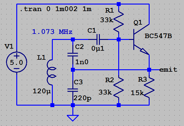

  • #59
The multimeter detects the resulting output as being a voltage that oscillates between + 120 milliVolts and -120 milliVolts, far lower than the input 9 Volts, although the current from the battery reaches 7 milliAmperes. And I did use the capacitance values from the diagram, four 0,1 microfarads capacitors and one 1 microfarad capacitor.
The only thing I didn't follow was the resistance values, as I didn't find resistors for sale with these exact values: 2.2KΩ, 4.7KΩ, 10KΩ and 560 Ω.
Also I did use a 1.35 microhenries inductor to obtain a resonant frequency of 612,6 KHz for the tank circuit, given the effective capacitance of 50 nF.
