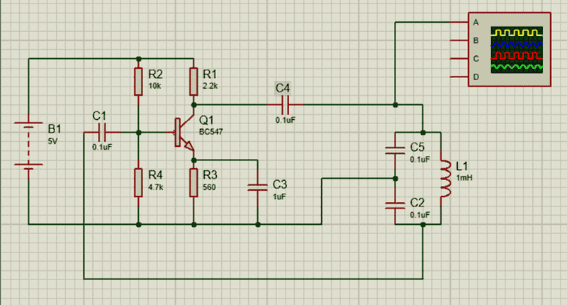

James2018 said:
Don't worry, I fixed the circuit.
I wasn't.
  • #122
James2018 said:
If the wires don't touch there, everything is working.
So, do you now hear a quiet frequency in the AM BC band that gets noisy again when you turn off the oscillator?
  • #123
C1 and C2 do not allow AC to pass. On one terminal they have full 5 V DC voltage and on the other they have 0 mV. Maybe they are faulty. Only C3 does block 5V of DC and pass 8 mV of AC. Strangely, because they are newly bought just a week ago and by the same manufacturer as C3. I used them in the previous circuit too. Every other component works as intended.
When I said everything was working fine, I meant a circuit identical to the real one, but in the simulation. In reality, the two capacitors don't work.

Check with ohmmeter that all grounds are connected to battery negative.
Disconnect L1 at the ground end. It should stop the oscillator.
Then measure the base and emitter voltages as in post #117.
Measure the disconnected L1 voltage. That voltage will be Vb or Ve, and tell you if C1 or C2 is shorting.

A digital multimeter will not measure a 1 MHz voltage or current. That is why you get silly results like 0.1 mV AC.
The circuit I gave you runs on about 200 uA total. That is almost nothing.
The RF output comes from the magnetic field of the inductor, where there is a 1 MHz current oscillating between ±2.6 mA, plotted below in yellow.
The base voltage is plotted in red, with the emitter voltage in green.
If you disconnect the inductor at the ground end, the oscillator will stop.
Then measure the base voltage, Vb, which will be about 2.5 V.
Also measure the emitter voltage, Ve, which will be about 1.6 V.

There are two capacitors and an inductor that connect to that node. Which one did you try? It is your multimeter that is not perturbed. It is not designed to measure AC current at RF frequencies.
I believe your coil is too long for its diameter, and the capacitors are too high a value. For an air cored coil, the length should be similar to, or less than the diameter.
What wire have you used to wind the coil? Is it insulated, have you got a shorted turn?
James2018 said:
no problem I will increase the coil length of the variable inductor so it can have 0.506 uH instead of 1.35 uH to get a resonant frequency of 1.001 MHz.
37 turns, 6.4 cm long = 64 mm long. 0.8 cm = 8 mm diameter.
I calculate 1.7255 µH.
If your series capacitors make 50 nF. Then the frequency = 541.8 kHz.
Being at the very edge of the AM BC band, there is a 50% chance the oscillator frequency will not fall in the band.
That is why I suggest 1 MHz as the target.

There are big problems with your tank circuit. The L and C values you have chosen make it difficult for the oscillator to start. You need to wind a higher inductance coil. The way you have it now, the circulating current in the tank would need to be ±250 mA to keep it oscillating, that might be possible if your wire was thick enough, and the capacitors were perfect, but they are not.
There are good reasons to build the tank circuit for 1 MHz using;
C2 = 1 nF ; C3 = 220 pF ; L1 = 120 uH .
MW BC band coils can be wound on toilet roll tubes. For 120 uH you should wind 75 turns, on a 38 mm diameter tube, and spread the coil over a length of 50 mm. That will require 9 metres of wire, but it will work well.

If I use a 470 uH inductor with ferrite core, what capacitance value would I need? By the way they do not really have a 1 nF capacitor anywhere for sale, but I did find a 220 pF capacitor and a 15 nF capacitor.
  • #139
For 1 MHz ;
f = 1 / ( 2 * Pi * Sqrt( L * C ) ) hertz.
C = 1 / ( L * ( 2 * Pi * f )^2 ) farad.
C = 53.9 pF.

Is there radio silence somewhere else in the band?
If not, slide the ferrite rod slowly out of the coil, listening for when the oscillator frequency moves up through the band.
Check the battery voltage, 5V; the base voltage, 2.5V; and the emitter voltage, 1.8V .
Why does nothing work for you?
Did you solder the wires or glue them?

I think you mean it does not draw current, because it is open circuit.
So the battery is not flat, but the wires are not connected.
How do you join wires to components?
Test the connection resistance with your multimeter.
Your blurry photos show what looks like clear sticky tape being used to hold wires down. The static electricity from the tape, when it is unrolled, may destroy the transistor base junction.
No, I have made the proper circuit by the original diagram and now it works. I have used those 2.2k, 4.7k, 10k and 560 Ohms resistances and it works. The only thing I did change was the tank circuit, with C5 and C2 replaced by 220 pF capacitors and the L1 replaced by the 470 uH inductor.
The antenna now has 10 mV of AC on average. No more 0 volts detection.
By the way, I tried other versions of the Collpits oscillator and they didn't work also, only this version did.
Thank you so much for your time and effort to try and help me.
