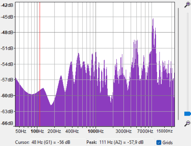

  • #91
If that spectrum is realistic, I suspect that those low resistor values have made the circuit into an RC oscillator.
I recommend that you put the correct resistors (as shown in the simulation) in the circuit; you might actually get the expected results. (The batteries will last longer too.)
Just for grins, change the resistor values in the simulation to the values you actually used. It would be interesting to see what results you get.

Oops, seems resonant frequency of my circuit is actually 40 Hertz. In this simulation I used every value for resistor, capacitance and inductance and input DC voltage like in real circuit.
Here is the animation to see AC is present in the tank circuit
  • #94
Antenna oscilloscope - not a pure sine wave, but beats

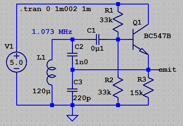

The Colpitts circuit you are using has bias voltage dependent on the Re and Rc values.
Here is a different Colpitts circuit, one that I prefer, it uses fewer components and the bias is not dependent on the exact resistance values. Design is for 1 MHz. It has no antenna, the RF output is from the coil current of ±2.7 mA peak, while the circuit runs on less than 0.5 mA.
Here is a different Colpitts circuit, one that I prefer, it uses fewer components and the bias is not dependent on the exact resistance values. Design is for 1 MHz. It has no antenna, the RF output is from the coil current of ±2.7 mA peak, while the circuit runs on less than 1 mA.
And it doesn't matter what resistance values I use, at all? And what values are for capacitance for C1, C2, C3? I don't understand the codes.
The convention on circuit diagrams is to move the SI prefix to where the decimal point was. That prevents problems with missing decimal points.
C1 = 0u1 = 0.1 uF = 100 nF.
C2 = 1n0 = 1.0 nF.
C3 = 220p = 220 pF = 0n22.
Keep R1 = R2, at about 33k. Anything from 22k to 47k is OK.
Make R3 about half of R1. 12k to 22k should be OK.

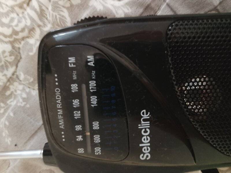

I assembled your circuit with the 33k and 15k resistors and the BC547B transistor, but I kept the values in the resonant LC to the original effective capacitance of 50 nF and effective inductance to 1.35 uH, I did not use 220 pF and 1 nF and 120 uH because I want to keep the original frequency of 612.6 KHz. I will test the radio AM reception soon, when I am not busy.
  • #114
James2018 said:
... because I want to keep the original frequency of 612.6 KHz.
I don't think the frequency is 612.6 kHz, because if it was, you would hear the quiet spot there with the AM radio.
You need to wind a coil with the correct inductance to oscillate at 1 MHz, that is the mid-point of the BC band. You can then have 60% errors, and it will still be in the AM BC band.

no problem I will increase the coil length of the variable inductor so it can have 0.506 uH instead of 1.35 uH to get a resonant frequency of 1.001 MHz.

Problem, this time no detectable voltage is reaching the inductor (yellow tube covered in tape) at all. May be under 0.1 milliAmperes, the transistor is correctly connected as I know and the resistances are all the right values and connected like in your diagram.
  • #117
The coil is grounded at one end, and DC isolated at the other with two capacitors, C1 & C2, so it should have zero DC voltage.
This circuit oscillates with a high signal voltage, about half the battery voltage, so that might make voltage measurements with a DMM difficult.
Check the base voltage is half the supply.
Check the emitter voltage is about 0.6 volts below the base voltage.
Build your circuit over a sheet of paper, so you can write clear values against components, and C B E against the transistor.
Compute the inductance. I cannot see the coil detail. What is the number of turns on the coil? What diameter, and how long is the coil?

  • #119
James2018 said:
I made one bad connection in the circuit, the wires are NOT supposed to touch where the red circle is, right?
Of course not. What would be the point of this? Think about how the transistor works and why that connection would be wrong. At this point I would have hoped you would understand this.
  • #120
Don't worry, I fixed the circuit.
