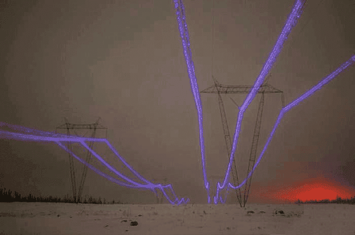

Are you thinking about corona discharge? That is caused by ionization in the air, not the electrons in the wire, and in the range 100-1000 kV
https://en.wikipedia.org/wiki/Corona_discharge

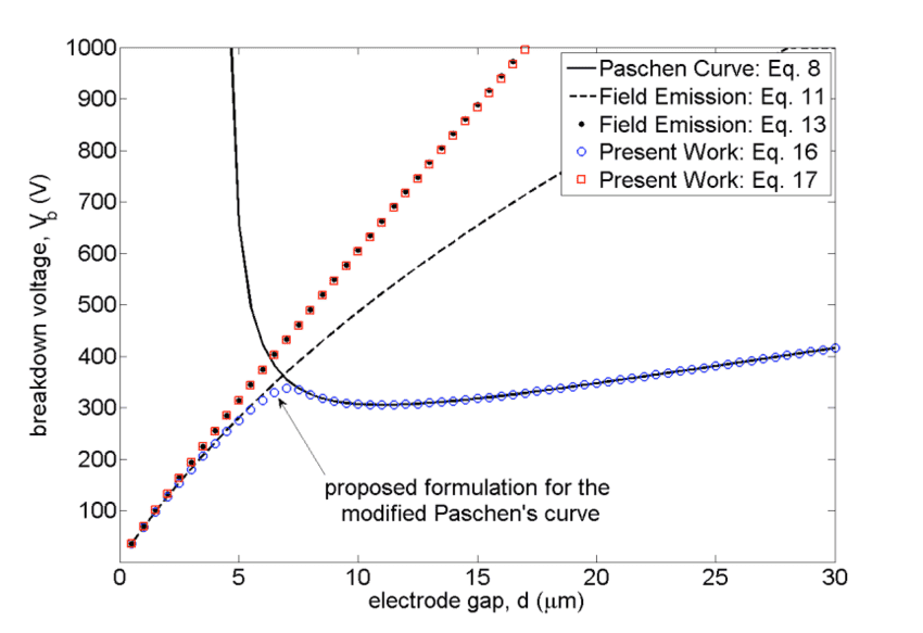

I was looking around the topic and, of course, as well as photo emission, thermionic emission came into what I read. At room temperature, the field required is much higher than for a 'hot cathode'. I get the impression that the energy required for an electron to leave the surface is highest for Field Emission, then thermally assisted Field Emission, Field assisted thermionic Emission and Thermionic Emission, when the electrons are continually 'boiling off'.
I found the https://www.researchgate.net/figure/Paschens-breakdown-voltage-Eq-8-the-field-emission-breakdown-voltages-in_fig8_224141072 which shows (afaics) that field emission will dominate for very small gaps but the Paschen curve for air breakdown seems to go below the field emission curve as gap size increases.

The electrons around the outside of the metal under these conditions can form a 'cloud'. It's referred to as a space charge which hangs around unless conducted away. (Much the same situation as for thermionic emission)
View attachment 268126The electrons around the outside of the metal under these conditions can form a 'cloud'. It's referred to as a space charge which hangs around unless conducted away. (Much the same situation as for thermionic emission)
