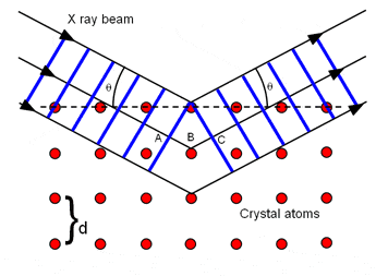

So in bragg's law [itex]2d\sin \theta =n\lambda[/itex], n needs to be an integer. Can anyone explain why? I mean, what if the extra path 2d that the 'second beam' has is not dividable by a wavelength?

If the extra path 2dsinθ is not an integer multiple of the wavelength, then you don't get constructive interference, hence no wave for that angle θ.
Ah, yes! Sorry just also came up with that haha. Thanks!
