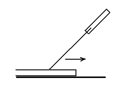

Moving the magnet up and down the mid-shaft area doesn't change the flux through the turns. Try wiggling the magnet at one end of the rod.
Also, put your meter on an AC Volts setting. You will see the induced EMF from the changing flux through the coils.
And check the resistance of the coil.
You may not have removed the insulation doing it like that.
I lay the wire on a hardwood surface and scrape with a razor blade until I can see copper and solder to it.
