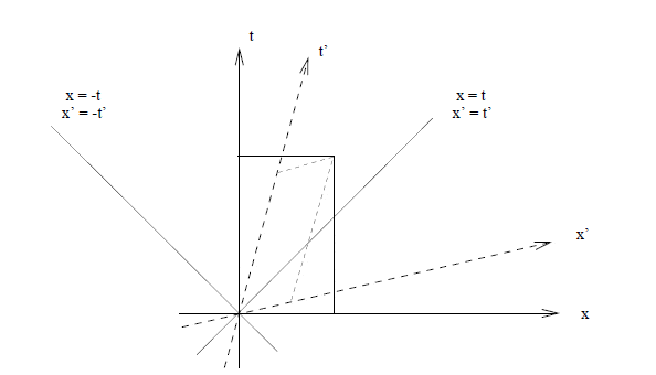

The speed c, distance over time, is the tangent of the furthest angle from both the space and time orthogonal basis vectors. The 45 degree angle.
Since these basis vectors transform in a way that they collapse in on each other, this tangent never changes in any set of coordinates (reference frame).
See attached picture.
Greetings,
It seems like you have an explanation, but I don't quite understand it :-p
Could you elaborate?

It is not a mystery, c is exactly the tangent of the 45 degree angle between the space and time basis vectors (which is always 1 y/x), any transformation will leave this tangent the same. After completing a special relativity course (which can be done in a 1 day cram) it can be fully understood. The big factor is that speed is a derivative of space.
But this is again experimentally shown isn't it? Is there any available derivation?

It is just a consequence of our choice of axes. We usually choose the time axis to be perpendicular to the space axis with two dimensions supressed. The space axis units are chosen to be one meter and the time axis units are chosen to be one light meter. With this choice of axes the light path referred to these axes bisects the angle between these axes, that is forty five degrees to both axes.
Whatever the speed of light happened to be we could always set up the axes so that the light path makes such an angle with the axes.
