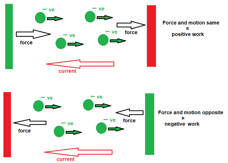

Ok, so the (conventional) current is flowing from the positive plate to the negative. So the negative electrons are moving in the opposite direction, from the negative plate which is repelling them towards the positive plate which is attracting them.
So the charged capacitor plates are exerting a force on the electrons in the same direction in which they are moving. Therefore it is doing positive work.
Later when the emf from the inductor is pushing the electrons towards the negative plate (b to c) then the electrons are doing work on the capacitor. Now the capacitor is doing negative work on the electrons, because the force from the negative plate is repelling the electrons, but they are still moving towards the negative plate (aided by the inductor emf.) Force and movement are in opposite direction, so work is negative.

Great reply. Thanks for the time and effort.
This is what I suspected. That the work is positive because the electrons are moving in same direction as the force from the electric field.
The second scenario also makes sense.
