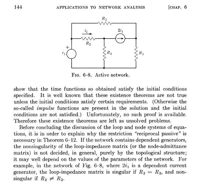

TL;DR Summary: How to write down the loop-impedance matrix in case of Current-Controlled Current Sources
Hi,
as in the following linear network, I would like to write down the loop-impedance matrix for it where there is a CCCS ##2i_1## source.
The starting point is the network elements equation: ##V(s) = E(s) + Z(s)I(s) - Li(0+) + \frac {1} {s}v_c(0+)##
How can we 'fit' the CCCS source in the branch-impedance matrix ##Z(s)## ?

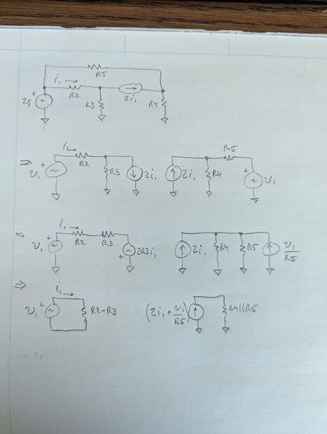

However, you may find the answer, at least for special cases by working out the Kirchhoff equations and reforming them into the canonical matrix form. i.e. work the problem backwards until you see a pattern. For this network it's easy to solve for the CCS in terms of the voltages, which should give you an impedance term to put in your matrix.

Sort of, I meant solve some of the network equations for the voltage across the current source. It looks, for this example, that you can find the current as a linear function of the voltage across it, hence an impedance.

Use KCL at the central node, then KVL on the loop with the voltage source. That will solve for the current i1 and the voltage at the central node. To find the other voltage you can then solve the outer loop.
Call the nodes starting from the left A,B,C.
The KCL at central node B is ##i_1 = \frac {v_B} {R_3} + 2i_1## and the KVL is ##v_1 = v_A = R_2i_1 + v_B##. From these we can solve for ##i_1## and ##v_B##.
Then from the KCL at node C ##\frac {v_1 - v_C} {R_5} + 2i_1 = \frac {v_C} {R_4}## we solve for ##v_C## and then we get ##v_C - v_B## i.e. the voltage across the CCCS source.
The above is the complete solution for the voltage across the CCCS; in order to get the linear non homogeneous relation between current and voltage across it suffice just the first and the last KCL (KCL at node B and at node C).
This sort of network can also be solved "graphically" with various source transformations, as below. This is why I dislike and never use the systematic linear algebra approach IRL. It's great if you're a SPICE program, but a lot of unnecessary work if you can just pick apart the network sort of by intuition and equivalents. Of course it only works for small networks.
Also you can use superposition to solve the outer loop quickly since the current source is independent of the outer loop values.

I was referring to the general concept. Also, as I said before, when you are solving the outer loop, the current source is effectively independent, since it doesn't depend on parameters in that loop. As shown in the second step of my circuit manipulations above, this network can nearly be split into two parts.
However, you are correct, that method won't work for the inner T section.

Just a point to be highlighted: from my knowledge Superposition is feasible only if the network has just one solution (i.e. the coefficient matrix of the solving system is not singular). Otherwise it could exist infinitely many solutions for the network when all the sources are non-zero and no solution when only one source is non-zero.

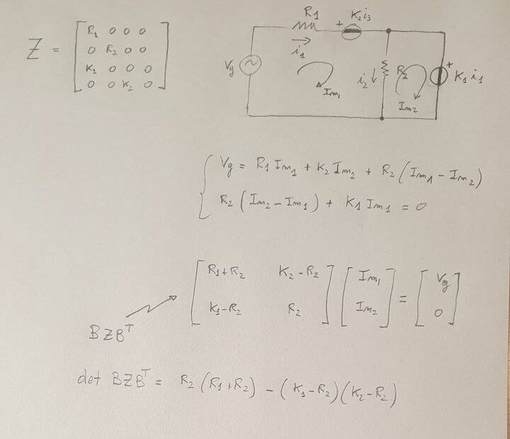

Yes, OK. Can you show me an example of a LPN that has multiple solutions for identical ICs? Let's exclude the trivial case of parallel voltage sources and series current sources, which are generally forbidden. Superposition requires linearity and vice-versa.
I found this trivial example having infinitely many solutions when the loop-impedance matrix becomes singular. In that case to get solutions the voltage ##V_g## has to be zero otherwise the system is incompatible.
Another trivial case is a 'cut' of current generators.
It's not passive. Yes, loops with only voltage sources and capacitors, or a cutset of only current sources and inductors doesn't have a general solution.
