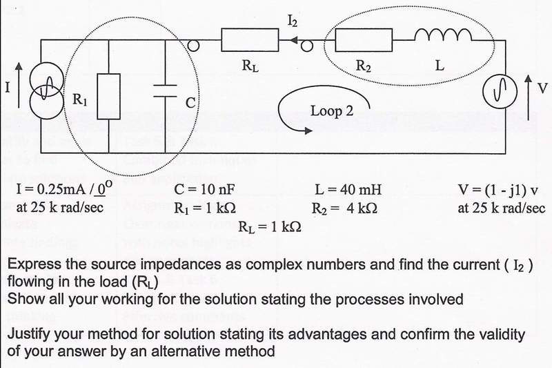

Hi Everyone.
I have been looking at this questions for a while now and have just hit a brick wall.
I have found the source impedances using the the following
Z of Current source = 1KΩ - jXC
=1000 - j4000Ω = 4123<-75.96°
Z of Voltage source = 4KΩ + jXL
= 4000 + j1000Ω = 4123<14.04°
Correct ?
But from here I am not sure how to approach determining the current I2.
Any kind of guidance would be greatly appreciated.
Thanks
how did you got your value for Xc ?
Plus ! you can use KVL in the loop having voltage source !
Using the following formula:
1/jwC
=1/j(25K rads/sec)(10nF)
Thanks
shouldn't the angular frequency should be converted into hz ?
I could'nt be sure but I assumse that when the formula states Omega it uses its standard form.
i think we need to convert it !
