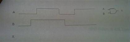

Sketch the output waveform for the given circuit and inputs (see attachment)
For AND gate: x = AB (multiply the inputs to get the output)

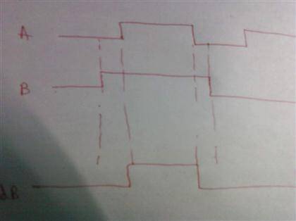

attached is my sketch.
How to multiply 2 waveforms?

Your 2nd sketch looks correct. The AND of A and B will only be high if both are high at the same time.
I guess you could call the AND function a multiplication, if you multiply the logical values (0,1). You can only get a 1 out of that multiplication if...
thanks for the clarification!
