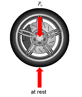

For the direction of the forces acting on a rolling tire, here's an animated drawing for an explanation (It comes from the link I gave you in another thread):

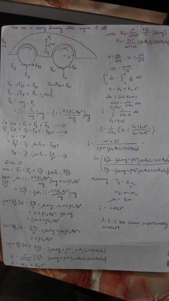

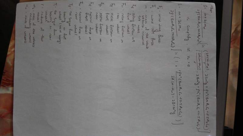

Hi Jack, sorry for the late reply, i was quite busy for the past few days.
you are solving the question by taking the braking force as percentage of the max friction force. Can I approach the question the other way? that is by using sum of moment equals to mass moment times angular acceleration as well as linear acceleration equals to radius of wheel times angular acceleration. I am doing this because I want to include the effect of mass moment of inertia into the equation.
Let's say, there is this situation, a 3 wheels car, two at the front and one at the back. the engine is driving the back wheel. the engine drives the rear wheel until certain car speed and then the engine is turned off. by using clutch, the rear wheel is free from the chain (or whatever driving mechanism), thus basically, after the engine is turned off, the rear wheel and front wheels roll freely. What I wanted to find is an equation that determine how far the car will travel when it reached a threshold speed, in which the engine is to be started and drive the rear wheel again.
I wanted to include the moment of inertia of wheel into the equation, thus i am using the method i mentioned above. I am assuming the factors that slow the car down are the energy loss from bearing (modeled as a resisting torque acted on the wheel in my calculation), wind drag as well as rolling resistance. Am I missing any more factors here?
After the calculation is done, I found that my equation is kind of strange, that is, the distance may have negative sign under some situation. Is it possible for you to tell me where I got wrong? Or my way of analyzing the situation is completely wrong?
Attached is my calculation.

Poligon said:
(...) the rear wheel and front wheels roll freely. What I wanted to find is an equation that determine how far the car will travel when it reached a threshold speed, in which the engine is to be started and drive the rear wheel again.
Let's go back to basic. No matter what, this is true:
ma = Fdrag + Frolling resist + Ffriction
Now, the friction force is the result of a torque applied to the wheel. This torque can come from a braking system (by friction or otherwise), resistance from the mechanical components, engine compression or any other internal resistance forces (wanted or not) you can think of. We assume that this wheel torque is independent of the car speed or acceleration and that it is constant during the deceleration process.
If there is no braking torque and we assume that the mechanical resistances are negligible and we assume the engine is disconnected from the wheels than the friction force is zero:
Or:
a = fr g + 0.5 rho / m [CdA - fr ClA]v²
With the help of HPWizard.com - and from what I saw in the calculations you presented -, you can find the distance traveled between an initial speed and a final speed.
There is an easy way to include this in your calculations. You have to introduce the mass factor (Km) in the equation:
Kmma = Fdrag + Frolling resist + Ffriction
Which means that the only difference will be that you have to divided the deceleration found earlier by the mass factor to get the actual deceleration (including the mass moment of inertia of the rotating components). The mass factor is defined by:
Km = 1 + sum(IxGx²) / (m rw²)
where:
Ix is the mass moment of inertia of rotating component x;
Gx is the gear ratio between the wheel and the rotating component x;
m is the vehicle mass;
rw is the wheel radius.
For example, if the mass moment of inertia for all wheels is Iw (Gw is obviously 1) and we also want to consider a driveshaft with Id known and rotating at an angular velocity 3 times faster than the wheel, then:
Km = 1 + (Iw + 9Id) / (m rw²)
No matter what, the mass factor is always greater than 1.
More detailed info here and here.
