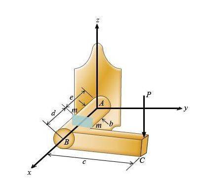

A locked door handle is composed of a solid circular shaft AB with a diameter of b = 108mm and a flat plate BC with a force P = 69N applied at point C as shown. Let c = 532mm , d = 126mm , and e = 153mm .
\taumax = \frac{Tc}{J}
T = internal torque acting at cross section
c = outer radius
J = polar moment of inertia → J = \frac{\pi}{2}c4
I've converted all mm to m.
I just wanted to see if someone could verify that I am on the right track.
radius, c = 0.054 m
1. The torque caused by the P force:
69 N × 0.532 m = 36.71 N*m → acting along the length of the solid shaft.
2. Internal torque, T:
T = 36.71 N*m *0. 126 m = 4.62546 N*m → acting at section m-m
3. J = \frac{\pi}{2}0.054 m4 = 13.36×10-6m4
\taumax = \frac{(4.62546 N*m)*(0.054 m)}{13.36×10^{-6} m^4}

Is the problem asking for max shear stress at the section m-m? You left out the actual question.

Yes, but I wouldn't say it acts 'along' the length: it is an internal torque that acts about the axis AB
Why are you multiplying a torque by a distance? Your result is in N*m^2 and incorrect.
Once you calculate the torsional shear stress, there is the vertical shear stress to consider from the vertical load P.
Please state the question.

The OP incorrectly identified the torque in item 2 of Post 1. The vertical shear in the rod was also neglected, if that is what the problem is asking.
