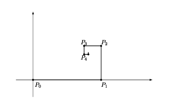

Let \{P_i\}_{i=0}^\infty be a sequence of points on a plane. Suppose P_is are placed as on the picture below, so that |P_0 P_1|=2, |P_1 P_2|=1, |P_2 P_3|=.5, |P_3P_4|=.25, ... Find the coordinate of the point P = \lim_{i→\infty} P_i
here are the points P_0: (0,0) P_1: (2,0) P_2: (2, 1) P_3: (1.5, 1) P_4: (1.5, .75) P_5: (1.625, .75)
lets examine the x values first:
2, 1.5, 1.625
this is a sequence defined recursively by:
a_1 = 2
a_{n+1} = 2 - \frac{a_n}{4}
L = \lim_{a_n\rightarrow\infty} a_n = \lim_{a_n\rightarrow\infty} a_{n+1} <br /> = \lim_{an\rightarrow\infty} 2-\frac{a_n}{4}
which means that
L = 2-\frac{L}{4}
4L = 8 - L
5L = 8
L = \frac{8}{5}
L = 1.6
so 1.6 would be the x coordinate of the point.
I then would follow a similar process to find the y coordinate, but before I do that I just want to make sure what I have so far is correct.
also forgive me for not proving the sequence is bounded and decreasing (I left it out to save time and narrow the focus) but i have done so by mathematical induction
Yes it is correct but also prove it is bounded and decreasing.
Ok so it turns out one of my induction proofs was wrong. I can prove it is bounded but this sequence is not strictly increasing or decreasing. it hops back and forth between increasing and decreasing but it IS approaching a certain point. Is there any way to prove that it has a limit?
the proof that it is bounded:
1 ≤ a_n ≤ 2
\frac{1}{4} ≤ \frac{a_n}{4} ≤ \frac{2}{4}
-\frac{1}{4} ≥ -\frac{a_n}{4} ≥ -\frac{2}{4}
2-\frac{1}{4} ≥ 2-\frac{a_n}{4} ≥ 2-\frac{2}{4}
1.75 ≥ a_{n+1} ≥ 1.5
1 ≤ 1.5 ≤ a_{n+1} ≤ 1.75 ≤ 2
1 ≤ a_{n+1} ≤ 2
