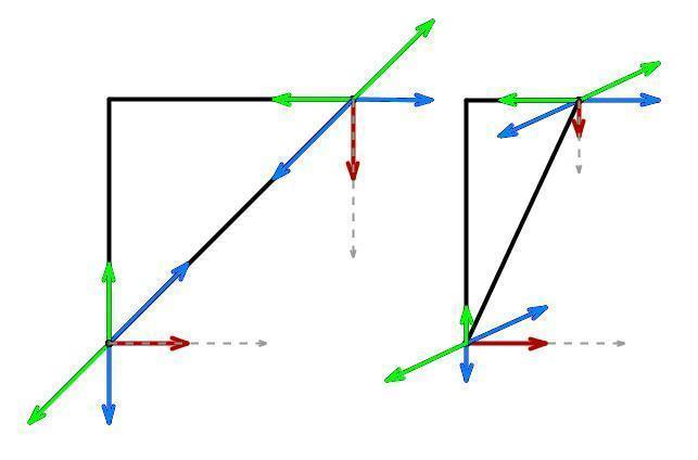

Hi Pervect,
I had a look at the image you posted in the other thread. The direction of motion is not clear from the image and the two atom get further apart in the moving frame but reading between the lines the moving frame is going down the page rather than the usual left to right. I have taken the liberty to add in the lever outline and diagonal cross beam to your diagram and indeed it appears that the reaction force inside the cross beam appears to create an internal torque in the moving frame compensating for the imbalanced external torque. Unfortunately that is not the whole picture and the diagram fails to take account of all the forces and glosses over the fact that the compression forces (that are not shown) also rotate when transformed and the end result there is no net torque in the diagonal cross beam that can compensate for the inbalance of the external torque.
I have created a second diagram showing all the forces involved. The dashed vectors are forces within the springs connected to the right angle lever. These forces are resolved into compression forces on the cross beam and tension forces on the lever arms (blue vectors) and torque forces (red vectors). The reaction forces are represented by the green vectors. When all these forces are transformed in the moving frame (moving left to right in the diagram) it can be seen that all the compression and tension forces remain in balance with their respective reaction forces and the the main torque forces (red vectors) are still out of balance in the moving frame. I have adhered to the guidelines you mentioned that spatial dimensions contract in the direction parallel to the motion of the frame while forces reduce in the plane tangential to the motion of the frame. When all the forces are taken into account, internal torque seems to fail as an explanation as to why the lever does not rotate in the moving frame.
I think you're missing the point I'm trying to make, or maybe I'm just not explaining it well.
If you look at the conservation law for the angular momentum of a system of particles in a standard mechanics text (for instance, Goldstein, Classical Mechanics, pg 6-7) for the conservation laws of angular momentum of a system of particles, you'll see that it is necessary for the forces between particles to lie along the line joining them.
Specifically, *assuming* the above condition is true (that the forces are directed in a line between the particles) and assuming also that the forces are equal and opposite (Newton's first law), it can be shown that the time derivative of the angular momentum of the system of particles is equal to the moment of the external force. This is done in the textbook I mentioned, for instance.
The necessary pre-condition of the force lying along the line connecting the particles is, however, not met in the moving frame. The theorem above fails, and there is now a contribution to the expression of the time rate of change of angular momentum of the system due to internal forces, as well as external forces.

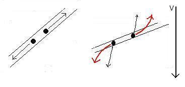

I guess we are missing each others points. ;)
If we take two charged particles with the same sign of charge then they repel each other. If we take the two particles in your drawing the like charged particles go away from each other and follow a straight path that I have shown as as two parallel lines in the rest frame on the left of the attached drawing. The drawing on the right of the image is moving frame showing the transformed path and the transformed forces. It can be seen that the transformed forces would cause the particles to follow a curved path (shown in red) in the moving frame. Obviously that does not happen or this would be a method to detect absolute motion.

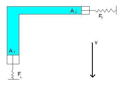

Hi Kev,
OK, so we can't model it with springs. It sure doesn't work. And my spring equation for the compression case is wrong. But, if we have a spring-based clock, the frequency is given by,
[tex]\omega^2 = K/m[/tex]. From a boosted frame, the clock is slower so K must decrease - or what ? My assumption that K is the same in all frames is suspect.
It can be quite difficult to visualise why spring forces transform as they do, but it can be quite easy to see how hydraulic forces transform. Assume we have a vessel that consists of two cylinders joined at right angles to each other to form two arms. The far ends of the cylinders have pistons of equal areas attached to springs. THe vessel is filled with water and put under pressure. In the absence of a gravitational field it is known that the pressure everywhere inside the vessel is equal in all directions. The pressure within the cylinder is the same in the rest and moving frames as otherwise we could detect absolute motion simply by attaching pressure gauges to a pressurised vessel.
The force on the pistons is simple the area multiplied by the pressure. It is easy to see that the area of the piston in the arm parallel to the motion is unchanged (A1) and so the force there is unchanged. The area of the piston in the transverse cylinder (A2) is reduced by gamma. The force on that piston is also reduced by a factor of gamma. To maintain equilibrium we have to assume the force in the transverse spring (FT) reduces by gamma and the force in the longitudinal spring (FL) remains unchanged.
Kev,
in your hydraulic vs springs, isn't there a decrease in the volume of the container, and therefore an increase in pressure ?
This goes against intuition ( but I'm not denying it might be correct).

Mentz114 said:
Kev,
The volume of the container decreases, but so does does the volume of the water by exactly the same amount so there should be no change in pressure.
I'll get back to the rest of your post later (my bed time) but thanks ;)

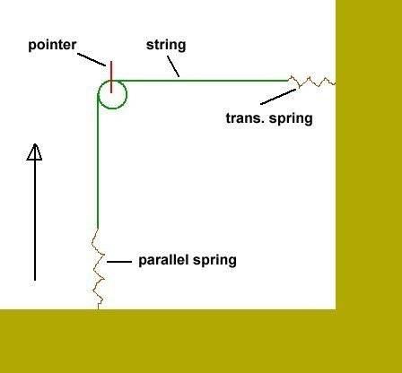

Hi kev,
that's very satisfactory. So the bulk properties of materials can look different from different frames. I suppose that is to be expected because those properties depend on the configuration of the EM fields holding it together.
But that leaves the 'paradox' untamed. I'll have to think some more ( and if all else fails, read the proposed solutions).
Thanks for running with this, it's a clear piece of analysis.
M
[edit] later. I think there may be a problem. Have a look at the diagram. Here we have no lever but a piece of string. In the rest frame we have equilibrium when f1=f2, but in the boosted frame, the transverse force is reduced, and the pointer will turn anti-clockwise. The shortening of the parallel part of the string is matched by the overall contraction, so that won't affect things. The deformation of the pulley won't help ( I think ).
I leave it to you to point out why I'm wrong.
Regarding your 'geared lever' solution-
It should also be noted that the when the right angle lever is rotated by some small angle in the rest frame that the two arms rotate through different angles in the moving frame and the angle between the arms does not remain a right angle. I hope I have shown that the relativistic right angle lever has more in common with a "geared lever" than a classical lever and that the ratio of the tip displacements is a more generally applicable “law of the lever” than the simple ratio of the lever arm lengths.
Looks right to me. Especially the bit I've emphasised. The trouble is I can't think of experiment to test any of this.
Regarding the conservation of angular momentum -
I like to think the angular momentum is invariant in the transformations from frame to frame in accordance with the principle of conservation of angular momentum.
translational momentum is not invariant so I'd guess AM is not. I'll read the paper cited above.
Hi Mentz, I see what you are getting at.
In the case of a pulley system (say a block system with lots of pulleys as seen on sailing ships or cranes) the overall mechanical advantage is measured as the ratio of the distance the input end of the rope moves relative to the distance the output end moves. In line with conservation of energy laws the force(input) * displacement(input) = force(output) * displacement(output). In the relativistic moving frame this relationship is maintained. The reduced tranverse force is always compensated for, by the length contracted displacement of the parallel force.
Any mechanical system made up of a mixture of levers, pulleys and gears always obeys the more generally applicable law (based on energy conservation) that force(input) * displacement(input) = force(output) * displacement(output) in both the classic and relativistic cases.
Hi Kev,
OK, I'll stop looking for problems with the accepted view. I just set up the potential and field tensor for two repelling charges and did the Lorentz transformation at right angles to the line of the charges. The electric field in the transverse direction is reduced by gamma. Boosting along the line leaves the parallel component unchanged. I'm convinced.
Back to the drawing board.
M
