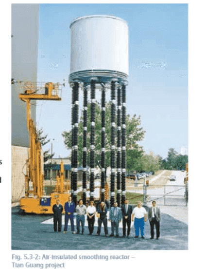

The link from UK to France has used DC for quite a few decades and that use(d/s?) mercury arcs. Cumbersome and expensive but worth it for spreading the load over the time differences.
That link does quite a job on HVDC but, apart from the RFI comment, it's not based on probable future technology but on what's currently available. Having seen solid state move from mW to kW and having more and more complex circuits (Flawless TV displays, for a start), I have to say it's feasible to think in terms of many MW systems. Also, the network could well involve more, lower power cables.

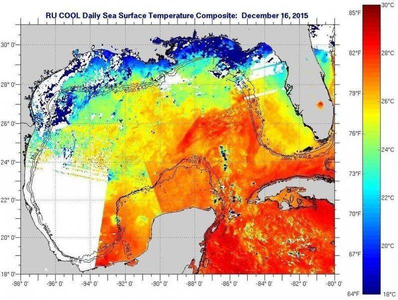

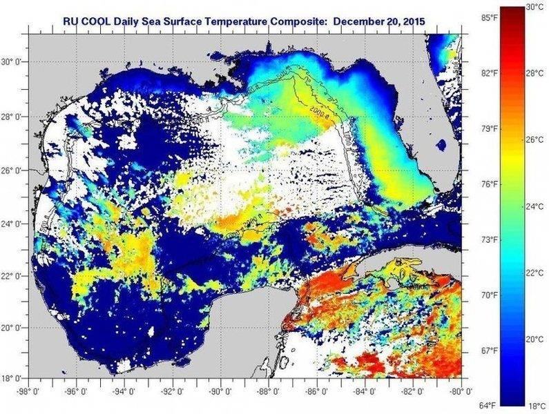

Ahhhh my old daydream.
Then we'd place thermopiles in Gulf of Mexico and Arctic Ocean , tapping off power all along the way.
Mother Nature's moving heat that direction anyhow with Gulf of Mexico edit oops, make that Gulfstream and atmosphere - watch your satellite weather this time of year you see huge sheets of clouds carrying enormous heat of vaporization from Gulf up across Tennesseee Valley then offshore at Northeast. US/Southeast Canada.
We'd help her along with her heat transport reducing Δ-temperature, maybe relieving severe weather like yesterday's .
Curious - i just can't seem to imagine decentralizing the grid. I guess i was imprinted by the big machinery.
from http://marine.rutgers.edu/cool/sat_data/?nothumbs=0&product=sst_comp&region=gulfmexico
Look how Gulf cooled between 16-20 Dec
old jim

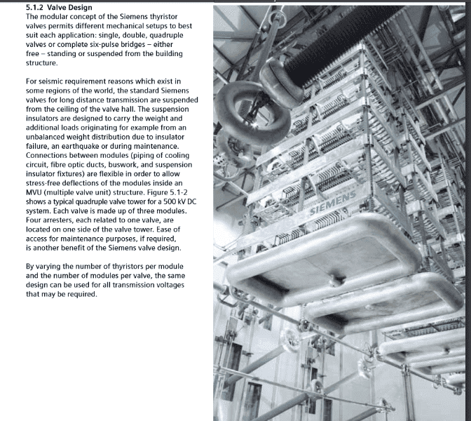

IF
one just replaced substation transformers with HVDC converters and suitable DC breakers
AND
L1 and L2 were opposite polarity and equal load
THEN
their return currents would cancel
so an existing 3 phase transmission line's neutral would only have to carry L3's return current
might one base load L1&L2 to actual demand and use L3 for the short term fluctuations?
Question for somebody closer to power systems than me. Real time sub-cycle telemetry opens new worlds for them.
Of course I'm assuming HVDC current is continuous, not pwm or something. I was never around any and just don't know how it works .
I do know one has to build into his converters protection against any modulation of load at frequency anywhere near the mechanical resonance of turbine shaft and blades , our was seven hz. Subsynchronous Resonance (SSR) is the term. That can cause a turbine to sling blades or snap a shaft and pretty much ruin your day.
