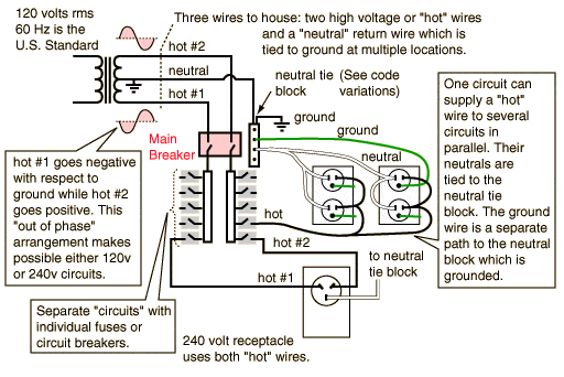

Note that in the US, residential 240V service is "split phase", with two hot wires at 180 out of phase with each other. This is an even more efficient use of wires as you've doubled the power you can deliver with the same number of wires (vs normal single phase).
  • #53
No no no. There are three wires in that system not two. Look at this diagram below from https://www.physicsforums.com/threads/total-amperage-in-a-service-panel.705961/ post #2 by Drakkith. Now suppose that nothing is plugged into the 240 volt plug. You see that the 120 volt current coming in from hot#2 must return through the neutral, not hot#1. The neutral is not the same as the third ground wire in plugs that is used for safety only.
proxy.php?image=http%3A%2F%2Fhyperphysics.phy-astr.gsu.edu%2Fhbase%2Felectric%2Fimgele%2Fhse.gif
Huh? If there is nothing plugged-in to the receptacle, then there is no current flowing at all. My suspicion is that some 240V receptacles use a neutral because for whatever reason they need to be capable of supplying both 120V and 240V. But they don't necessarily need to be: the alternate voltage of a 3-phase system (such as 240V) also uses two hot wires and no neutral. See:
All NEMA 6 devices are three-wire grounding devices (hot-hot-ground) used for 208 V and 240 V circuits...
NEMA 6 devices, while specified as 250 V, may be used for either 208 V or 240 V circuits, generally depending on whether the building has a three-phase or split-phase power supply, respectively.
https://en.wikipedia.org/wiki/NEMA_connector#NEMA_6

  • #58
No, look at the diagram.. If there are loads plugged into the 120V receptacles, but none in the 240V receptacle, where does the current flow?
The 120V plugs have three prongs, hot#2, neutral, and ground. The ground is for safety. The neutral is for the return path of current.
120V power flows from hot to neutral through 120V plugs in 120V circuits. We're not talking about 120V circuits, we're talking about 240V circuits.
No, 120V plugs have one hot and one neutral, for a total of two prongs (we've been ignoring the grounds, which some have and some don't). Some 240V plugs have a neutral, some don't. Have another look at my post - I've re-written it and provided an example that makes it clearer.
