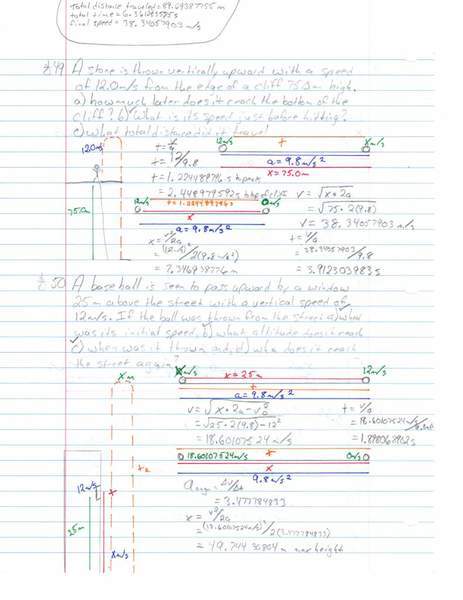

I can only attach one file So I will put a link to flickr.
http://www.flickr.com/photos/25742963@N04/sets/72157631801173637/
A avg.= delta v / delta t
x=v^2/2a
t=v/a
I have to do these problems for homework and usually when I have an issue with it I ask my teacher, thing is he has been out for the past two days and this is due tomorrow. All of them have work and equations on them but I do not know if they are correct. On numbers 22, 49, and 50 I could not find a logical answer. I think I may have the wrong equation for those.

At your first problem, I don't think you used the correct height. Your total height equals 75 m plus the height that stone achieves after being thrown from the edge of the cliff with initial velocity of 12 m/s.
