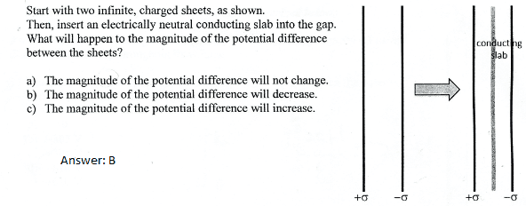

Add conductor between infinite sheet
The discussion revolves around the concept of inserting a conductor between infinite charged sheets and its implications. It suggests that the conductor behaves similarly to a capacitor, where charges reside only on the surface, indicating no charge within the conductor itself. The participants explore the idea that placing the conducting slab could effectively reduce the distance between the charged sheets, altering the electric potential. The relationship between the conductor and the electric field created by the sheets is also examined. Overall, the conversation highlights the fundamental principles of electrostatics in relation to conductors and charged surfaces.
CH1991
27
Please check attachment or picture below
http://i.imgur.com/ALG5d.png
Probably I should consider it as a capacitor? For a conductor, is that means no charge inside, charges are all on surface?
Thanks!
