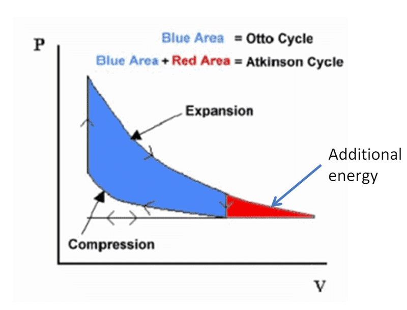

  • #31
Chestermiller said:
If the piston is massless and frictionless, then by Newton's 2nd law, the force per unit area exerted by the external atmosphere on the outside face of the piston ##P_{ext}## must be equal in magnitude to the force per unit area exerted by the gas on the inside face of the piston. That means that the work done by the internal gas on the inside face of the piston must be $$dW=P_{ext}dV$$
Could you give me the formula for the net work done on the piston in the adiabatic case?
If I'm not mistaken, you seem to be in agreement with jack action. I'd just like to clarify.

  • #37
Chestermiller said:
If it were an adiabatic reversible process, even if the piston had mass, if the cylinder were horizontal, the net work would be zero both at the end of the process (at final thermodynamic equilibrium) and during the process.
For an irreversible expansion, the net work done on a piston with mass during the process (again assuming horizontal cylinder) would be $$W(V)=\int_{V_1}^V{\frac{F_g}{A}dV}-P_{ext}(V-V_1)=\frac{1}{2}mv^2$$assuming that the externally applied pressure is constant. However, if the system has reached final thermodynamic equilibrium at the end of the process, such that the kinetic energy of the piston has been damped by the gas, then we would be left with $$W(V_2)=\int_{V_1}^{V_2}{\frac{F_g}{A}dV}-P_{ext}(V_2-V_1)=0$$and $$\int_{V_1}^{V_2}{\frac{F_g}{A}dV}=P_{ext}(V_2-V_1)$$
I’m lost now. How is work on the piston calculated then? Perhaps I used the wrong term. By net work, I meant work done on the piston.
If the piston had mass and the external environment was a complete vacuum (0 psia) then work would be done on the piston to move the piston since it has inertia.
Logically, if the external pressure was 14.7 psia, there would still have to be work done on the piston mass, but work would also be done on the external environment.

I'm going to chime in again as I feel both of you have difficulties understanding each other. I hope I won't add to the confusion.
For the OP, the piston of cross-sectional area ##A## is connected to something that offers a resistive force ##F## - like a crankshaft for example. The crankcase pressure would be at a steady ##P_{atm}##. On the other side of the piston, there is a combustion chamber with pressure ##P## whose volume varies from ##V_1## to ##V_2##. In one case, ##P## follows an adiabatic expansion, in the other, it follows an isobaric expansion. So the energy equation would be:
$$\int_{V_1}^{V_2}{PdV}=P_{atm}(V_2-V_1) + F\frac{(V_2-V_1)}{A}$$
(For simplicity, I'm assuming both sides of the piston have the same cross-sectional area.)
The "net work" the OP refers to is ##F\frac{(V_2-V_1)}{A}##, i.e. the useful work going to the crankshaft, where ##\frac{(V_2-V_1)}{A}## is the piston displacement.
If the piston has a mass, piston acceleration must also be considered, if any.
Feel free to tell me if I don't understand either of you correctly.
