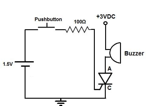

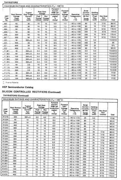

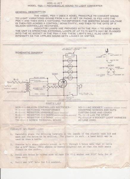

I have this chart from 1973 seems this is all the SCR's they had what I wanted to know is when it says typical gate trigger current is this the minimum needed to turn it on or is the maximum it can handle? I built this sound to light converter. What I can't figure out is it says SCR's latch on when turned on and you need to disconnect power to turn them off does that mean gate? If this sound to light converter where used with 12 volts DC bulb instead of 120 volt AC would this unit with this SCR still work? I also found the buzzer picture on line would not pushing the switch turn on and off the buzzer?

typical gate trigger current would be the minimum needed to give reliable turn on
With an SCR, the only way to turn it off is to interrupt the anode-cathode current by some external arrangement. If the SCR is connected to AC, this drops to zero every cycle, so the SCR automatically turns off by this fact. You can't turn off an ordinary SCR at its gate. There was a type that could be turned off at the gate, a second gate, unsurprisingly this device was called a gate turn off SCR; I've not encountered one.
As for your buzzer, the push button turns it on and it continues buzzing forever, or until you disconnect the 3V supply.

At least I know it works on AC not DC
No. Once you trigger the SCR with gate current, typically tens of milliamps, and establish anode to cathode current , the SCR will remain "ON" until the anode-cathode current drops to less than the value in your "Holding Current" column. Usually we design the circuit to force anode current all the way to zero just to assure turnoff.
So think of it as an automatic door - opens on a trigger to gate terminal allowing anode current , remains open until anode current becomes so feeble the door can snap shut again. But be careful with terminology in your analogies - an open door is same as a closed switch...

As noted you have to take the anode current below the holding current to turn off the SCR. The typical gate current to trigger is not the maximum that you could encounter. Somewhere in the specification there should be a maximum required gate current. However, in general you should be fine if you applied double the typical current. Be careful not to exceed the maximum gate power (or current if specified). While I have used a DC current in one application it is generally the practice to use a pulse on the gate. The SCR should have a turn on time specified and setting the gate pulse longer should work well. SCRs were popular before the power mosfets became available. They do have the advantage of being able to block voltage of either polarity.
When it says typical they mean it. That is the current at which most of the devices will turn on. Some will turn on with less gate current, a few will need more current to turn on. Their is often an Absolute Maximum gate current specified, which if exceeded, will damage the device.
As for the buzzer circuit, it depends on the type of buzzer. If an electronic type the SCR will likely stay on. If it is an old electro-mechanical type with electrical contacts that open and close during operation, the SCR may or may not turn off depending on the current thru, and the inductance of, the buzzer
