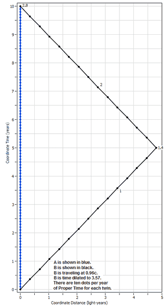

Ibix said:
That is your mistake. There is no inertial reference frame in which B is at rest for the whole trip. There is one where he's at rest outbound, but he's moving on the return leg. There is one where he's at rest returning, but he's moving on the way out. A is moving in both.

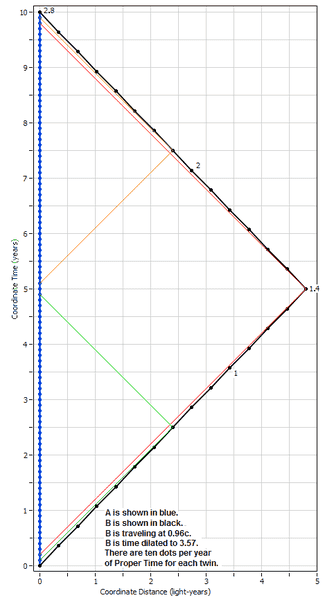

Experimentally, B will find after he turns around, if he is using radar to generate his view of the world, that suddenly it is much later on the Earth than before he turned around.
"In special relativity there is no concept of absolute present. The present from the point of view of a given observer is defined as the set of events that are simultaneous for that observer. The notion of simultaneity depends on the frame of reference, so switching between frames requires an adjustment in the definition of the present... In a sense, during the U-turn the plane of simultaneity... very quickly sweeps over a large segment of the world line of the Earth-based twin. The traveling twin reckons that there has been a jump discontinuity in the age of the Earth-based twin." - http://en.wikipedia.org/wiki/Twin_paradox

B is initially outward, in IRF1. Then at the turnaround point, B is suddenly traveling exactly coincident with C, who was always in IRF2 earthward and then they both return to Earth together in IRF2. So we are suddenly shifting from IRF1 outward to IRF2 inward. In IRF1, certain Earth times were in the future. In IRF2, many of them are suddenly in the past. If we define IRF1 and IRF2 using the Einstein method, which should be the same as the radar method for these IRFs, there must indeed be a discontinuity. [ this method appears to be different than plain old radar, since they are defining coordinates differently in the different regions? ]
[corrected url]
http://arxiv.org/abs/physics/0411008
"Title: A note on Dolby and Gull on radar time and the twin 'paradox'
Abstract: Recently a suggestion has been made that standard textbook representations of hypersurfaces of simultaneity for the traveling twin in the twin 'paradox' are incorrect. This suggestion is false: the standard textbooks are in agreement with a proper understanding of the relativity of simultaneity."

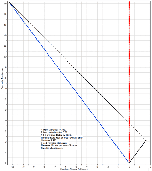

Suppose that A, B, and C are each using radar to generate their coordinate systems. Then A's radar coordinates will be the same as Einstein's method for the frame where A is at rest at the origin. Also, C's radar coordinates will be the same as Einstein's method for the frame where C is at rest at the origin. Now, B's coordinates never match with A's coordinates, but if you look in figure 5 in region F you can see that there is a region where B's coordinates do match C's coordinates.
The text below the figure describes it in some detail. Basically, in any region where the radar user is inertial between sending and receiving the radar pulse, radar coordinates give the same result as Einstein's method. However, where there is some acceleration between sending and receiving then you do get a difference.

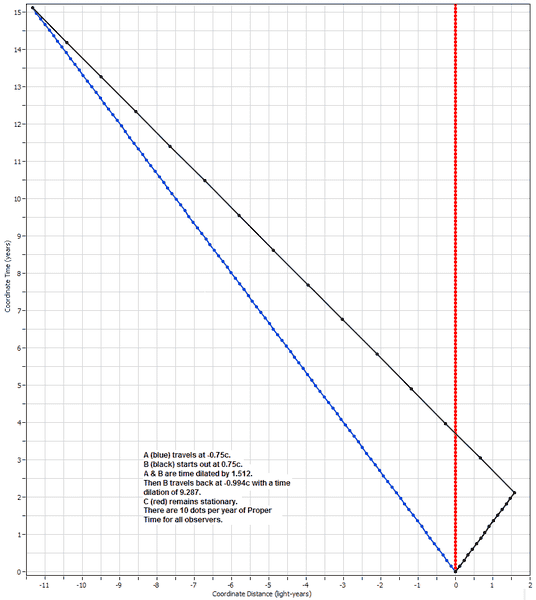

C is not at rest wrt the origin. C is traveling along with B's return trip.
Outbound, B agrees with A. inbound, B, agrees with C. B changes IRF at the far terminus. Dolby and Gull are creating something which is more elaborate the Einstein's method or indeed more than plain old radar.

You got it backwards. The traveler says that the home twin's age suddenly increases during the turnaround.
