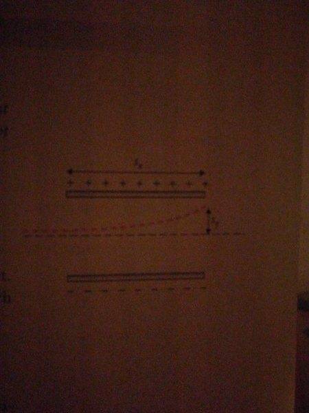

I am trying to figure put the angle and my attempt is tanx=sy/sx (I have calculated a value for the distances)
But my book is saying: tanx =vy/vx
I don't understand why my way of solving it is wrong... I don't get the same answer for x :/

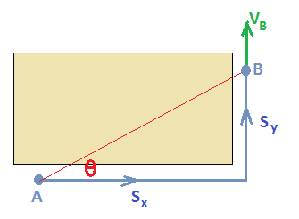

Suppose you drive your car around a corner from point A to point B. The direction you are traveling when you get to B is given by the direction of your velocity VB at B. The angle θ, such that tanθ = sy/sx, is the angle of the red line that connects points A and B. But this is not the direction that you are traveling at B.

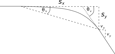

You are calculating two different angles. Here tanθs≠tanθv. See this picture for clear explanation:
