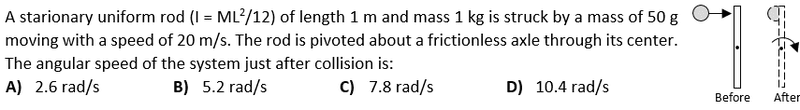

I did not attend this lesson due to some reasons. I read it from the book but I could not understand it well. I know the linear momentum well. However, in angular momentum, we have two equations I don't know which one is for which.
My Attempt:
Before:
We have only momntum for the mass that is moving..
L = mvr = 1 × 1 × 0.5 = 0.5
After
L = (Iball + Irod) w = w(Iball + 1/12)
That''s all what I could done

You have the right idea:
Lbefore = Lafter where L is measured relative to the axis of the rod.
It is just a matter of setting up the right side.
Lafter = Lball + Lrod
Can you complete the right side? (hint: you will have an expression in which the only unknown is ##\omega## the angular speed of the ball and rod after collision).
AM
Thanks,
Lrod = Irod * w = w * ML2/12 = w/12
but what about the Lball .. what forumla should I use?? L = mvr or L = Iw (can you help me to distinguish from them)
If L = Iw then what is I ? should it be mr2 ?
Paying more attention to your units should help.
It is good practice to never write numbers without their corresponding units when solving a physics problem.
Thanks but I still don't know how to find angular momentum.
Is it L = mvr or L = Iw
which one to use and when
OK, I solved it . The answer is 5.2
But I don't know when to use L = mvr or L = Iw
Thanks

The short answer is to use both. The motion of a rigid body can be expressed as the velocity of the mass centre plus a rotation about that centre.
The linear part contributes the mvr term, while the rotation adds an Iw term.
In many cases, one or other of these turns out to be zero.

The equation ##L = I\omega## is always true for a rigid body. The equation ##L = mvr = mr^2\omega## is true only for point masses. For a point mass, L = mvr = ##m(\omega r) r = mr^2\omega = I\omega## So for a point mass rotating about an axis a distance r away, the moment of inertia is mr2. For calculus purposes, one can think of a rigid body as being made up of an infinite number of point masses distributed according to the geometry of the body.

A useful application of this is for the standard question about a bowling ball which is initially sliding, not rotating. Taking moments about an axis on the ground, the initial angular momentum is mvr. When rolling, it is ##mv_fr+\frac 25 mr^2\frac {v_f}r=\frac 75 mv_fr##. Since friction has no moment about that axis, the initial and final are equal, yielding the final speed very neatly.
haruspex said:
As I wrote, it should be the distance from the (instantaneous) line of travel of the mass centre to the reference axis (not necessarily the axis of rotation). This is not an approximation, as I thought I showed with my integrals.
The initial angular momentum is mvr. But if it collides with and sticks onto a rod and starts rotating about an axis through the middle of the rod (as in this problem), you cannot ignore how that the mass is distributed and just treat it as a point mass. In this case we approximate the mass as a point mass and ignore the way it is distributed.

I feel you are not reading my posts carefully.
The motion of the ball after sticking to the rod is a rotation about the rod's centre, not a rotation about its own centre.
We can think of this as purely a rotation about the rod's centre, or we can think of its instantaneous motion as a linear (tangential) motion plus a rotation about the ball's centre. With the first option, we use the I given by the parallel axis theorem (I assume that is what you intended in your equation above); in the second, we use the I for rotation about the mass centre and add mvr.
Since ##mv_{final}r=mr^2\omega##, the two methods are completely equivalent.
