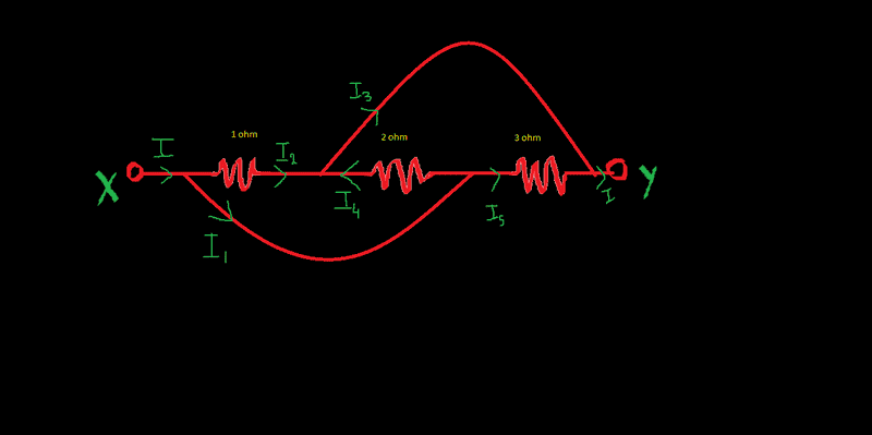

Calculate the resistance of this combination of resistors
V=IR
By using KVL :
V= 3[itex]I_{5}[/itex] = [itex]I_{2}[/itex] = 2[itex]I_{4}[/itex]
I = [itex]I_{1}[/itex] + [itex]I_{2}[/itex]
[itex]I_{3}[/itex] = [itex]I_{2}[/itex] + [itex]I_{4}[/itex]
[itex]I_{1}[/itex] = [itex]I_{5}[/itex] + [itex]I_{4}[/itex]
I = [itex]I_{3}[/itex] + [itex]I_{5}[/itex]Now the final result could be obtained by the simple equation : R =V/I (this is where my progress stagnates)

Your first equation relates currents I2, I4, and I5 to the potential across the circuit. Now, if you take your last equation and make substitutions so that you express I in terms of those same currents in the first expression, I think you'll get somewhere.
You mean like this :
I = [itex]I_{5}[/itex] + [itex]I_{2}[/itex] + [itex]I_{4}[/itex]
Thus R = V/I
that does not solve the problem ...
Thus R = V/I
But you can substitute your expressions for those currents from your first equation...
Oh yes, I overlooked this .
Thanks you
