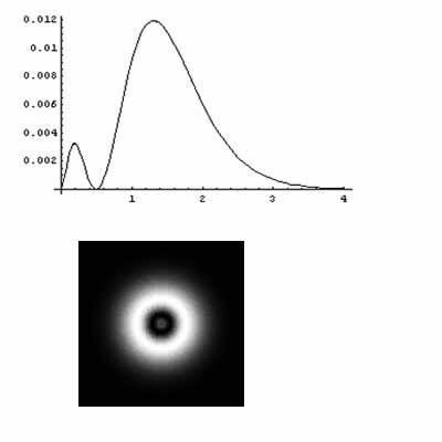

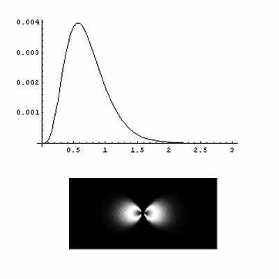

Hidrogen-like radial wavefunctions, although not valid for this case, can be used to qualitaively examine the behaviour of the radius (only in this little atoms, be carefull with this). If you look at the radial probability of a 2p state the maximum is not at higher radius value than the 2s, they are similar.
This is a 2s hidrogen-like radial probability graphic (for Z=4) and the corresponding contour plot in the xy plane, and the 2p plot for Z=7. Look at the maximums of prob. but don´t forget theese are hidrogen-like functions
