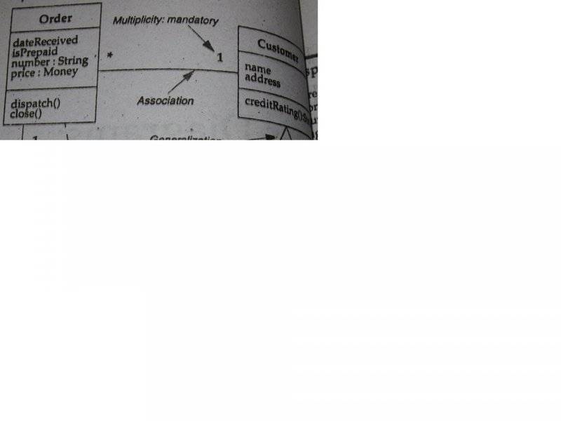

Hi,
I am using a book for studying UML. It shows attributes without any data types:
dataReceived
isPrepaid
number: String
price: Money
What is the data type associated with above two i.e dataReceived & isPrepaid & what is their visibility (i.e publc /private). Some body please guide me.
Zulfi.

Can you provide a screenshot of what you see? My guess is that there are other symbols there that you don't realize represent something. Are there what look like bullet points?

UML class diagrams usually include
Class name​
visibility attribute: type //for objects
visibility operation(arg list types): return type // for methods​
visibility varies among groups of coders, organizations etc. But public(+) and private(-) are two most basic keys every class diagram should have.
Hi,
Thanks for your response.
<Usually, if the return type is not shown, it returns void, but considering that your isPrepaid function probably returns a bool, my assumption is that you're missing some information>
Its an attribute not an operation. Maybe iheadset is right:
<visibility attribute: type //for objects>
It should be a primitive data type.
Zulfi.
Looks like just lazy UML diagramming to save space.
